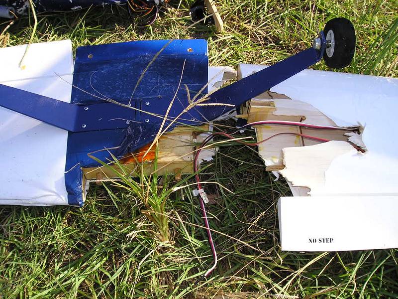

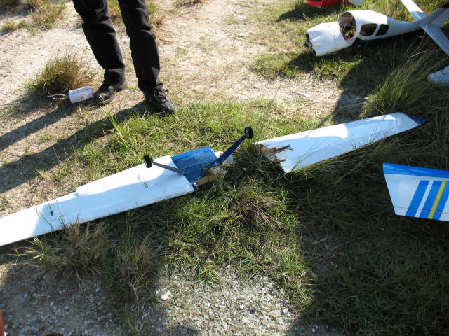

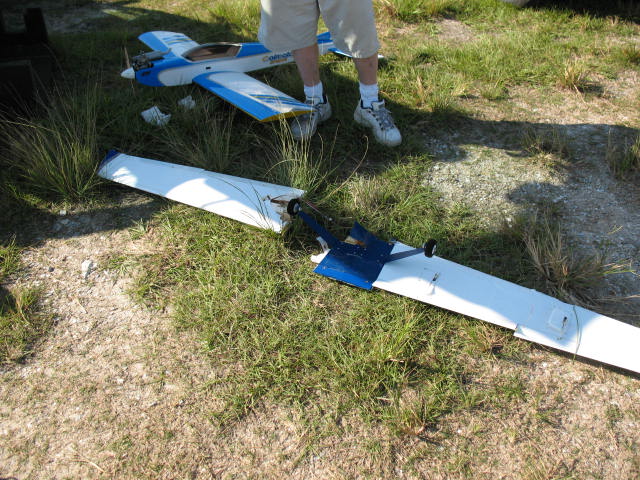

what's left of a great planes lancair. this guy was flying this one in a slight climb at medium speed and the wing snapped just short of the center section. this is the 2nd one these i seen do this in the last 6 months!. the 1st one i witnessed several months ago ,the flyer was doing a inside loop and when he pulled out the wing did the same thing this one did. anyone else heard of gp lancair's doing this?. hope the pictures uploaded
I've got one of these and so far (knock on wood) I haven't had any problems. There's a pretty good Lancair thread here on RCU somewhere and one of the first things recommended is to get the wings halves epoxied together and then take off about 1.5" on either side of the root and glass the whole center section of the wing with 3" fiberglass, top and bottom. From the sounds of the type of flying that was being done it was more scale than acrobatic, and that's one thing with this plane you've just to keep in mind, it's not for hard aerobatics. The only thing that concerns me about the pictures posted though is the fact that it looks like it busted right on the outside of what would be the edge of my fiberglass job [X(]. The Lancair thread is either in the ARF of Scale forum. Sorry for the loss of such a beautiful plane.
Joined: Jun 2004
Posts: 2,761
From: saginaw,
MI
its common sense to glass the center section . Experienced modelers know this. I think GP has amended the instructions and mention glassing. I do rolls and loops but im very careful on the power.
This plane has long slender wings ... best to glass them or even put a metal bracket to hold both sides of the UC together. Mine was glassed and she was ok. I did not pull any high G maneuvers at all. Was not flying slow but did not try any nonsense. Just you easy rolls and loops.

Happened to a club member last year. Looks like about the same spot. He was just pulling through a turn when it snapped In two.
Great Planes/ Hobbico sent him a new ARF no charge. I would have your buddy contact them and get a new kit.

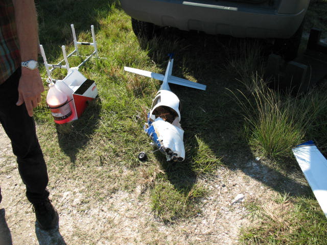

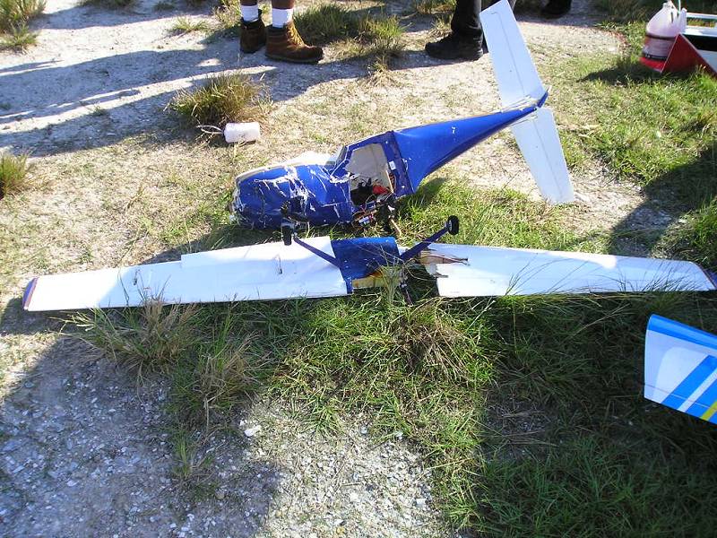

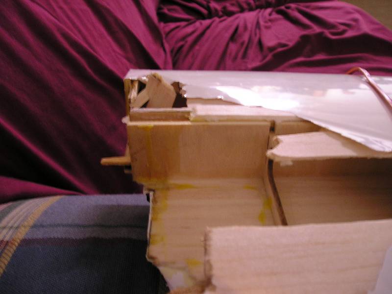

I am/was the said owner of this model. I believe an earlier wing strike might have lead to the
beginning of the end here. I was doing my normal approach, full flaps, steep approach when the
plane ballooned on the flare and tip stalled causing the wing to hit the ground. Very ugly
landing!
Now it didn't hit hard (just bent that high quality nose gear a bit
) but, I guess
it doesn't take much with the long wings. In retrospect, I should have checked the integrity
of that wing before I flew it again but in my haste to achieve the pretty landing, I flew her
again, climbed to about 100 ft.and "pop"! Flew straight down.
Definitely check the wing after any strike of any kind. Even if you glassed the wing like I did.
Here's a few photos of where the wing broke...
I will truly miss it. It's a nice flying aircraft with scale landings and approaches.

Definitely a gorgeous airplane but just a tad under built in the wing area. I became hooked
after my first smooth crosswind landing. There's just no other airplane like a Lance and this model
really captures it's spirit.
This is a laminar flow wing just like it's full-scale bretheren and unfortunately with a fully sheeted wing,
there's no way to really check for damage by just peeling covering. The one thing I REALLY dislike
is the fact that the grain in the webbing of the box-spar run up and down...this is really
a terrible practice when building wings and I think GP should really correct this.

The grain is supposed to run up and down. The purpose of the shear web is to keep the spars from coming together. The stress on the webs is diagonal and it shifts 90 degrees when the wing goes from positive to negative G. The best compromise, to align the grain with the direction of the average stress, is to put the grain vertical.
This old wives tail just won't go away. Glassing the center section of properly joined wing halves does nothing...
All you're doing is reinforcing the sheeting. If the wing is so poorly designed or joined that the sheeting is sharing the load than it's going to fail somewhere else anyway, unless you glass the whole thing. Case in point, look at the pictures of this wing. It was glassed, and broke at the edge of the fues! You will have a hard time finding a picture of an epoxied joint where the epoxy failed and not the wood.

glassing the center adds tremendous shear strength. the wood undulates as a sine wave in fligt. the glass helps hold it together
i have gp lanc and never had a problem. hitting a wing on landing will cause damage. the wing spar could have been damaged. the wing can be fixed as well as the fuse. might need new windows

I don't own one of these models, but from what I can see from the posted photos is that it would appear that the wing joiner was not glued to the main spar....that's why you have that lateral "slice" taken out of the bottom of the wing sheeting. If that's the case, then the wing joiner was merely aligning the wing halves and added no structural integrity to the entire wing.
Glassing the center section of a wing---- I'd do it for a balsa sheeted foam core wing but not neccesarily for a built up wing.
