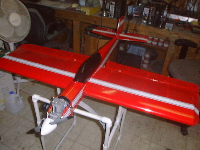

Here are a couple photos of my Magic Extra 300 with a 80 size Magnum four cycle on it..
