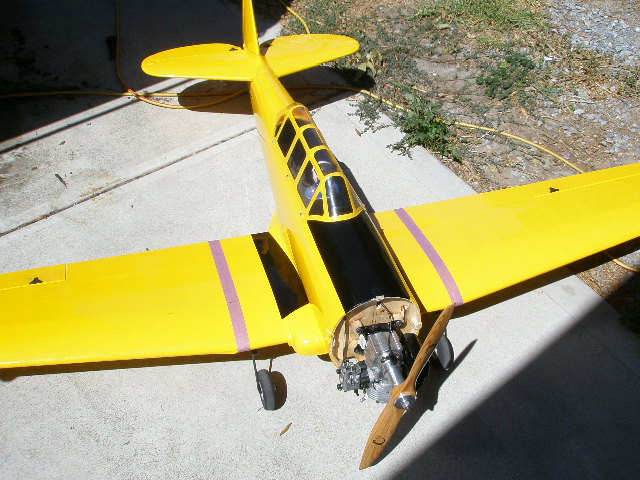

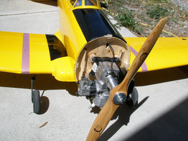

HERES THE PICS

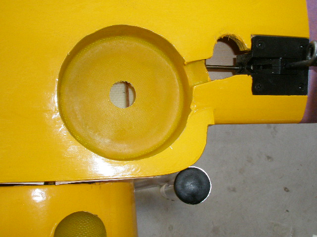

I measured from the front of the wheel bulge. next to the fuselage.

THANKS thats what i thought , as I can now go ahead and put all the servos and batts in and not add any more weight , front or back thanks again , Ian , Down under

Something just occurred to me , the whole engine mount with the anti vibes adds to the nose weight an extra 7oz , so mine is less that weight , but the gasser weighs 36oz , so 26oz for a 91 4st plus 7oz for the mount = 33oz .

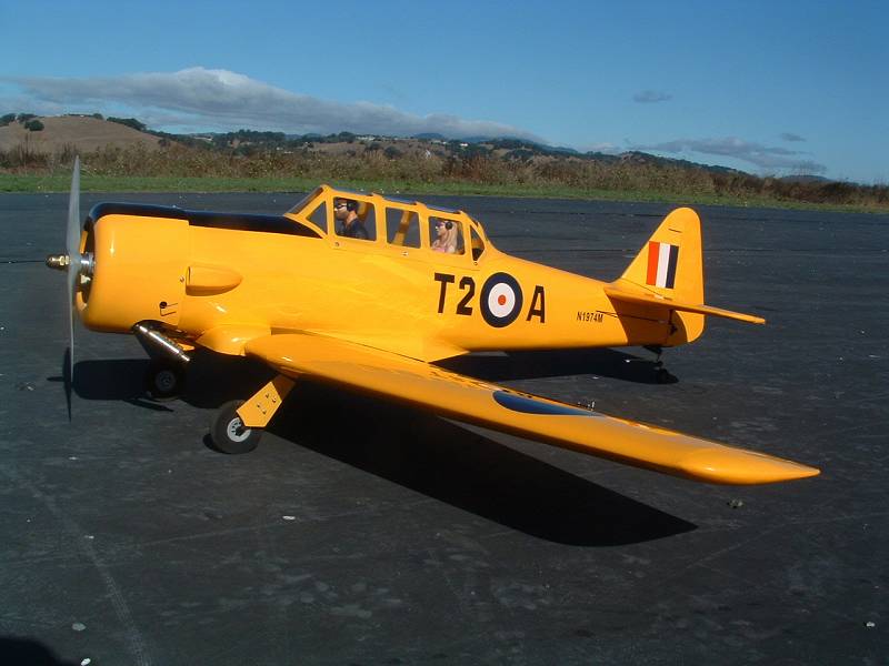

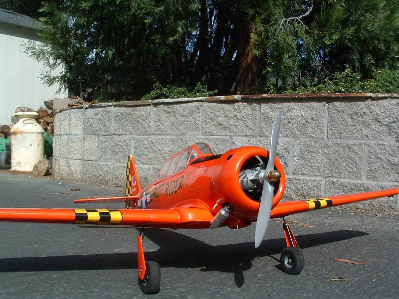

This one (VQ model) Flew well but didn't land or takeoff as well as our WM AT6. It had many tragic crashes for me and its next owner. With the big 26 you will have the gear rake in your favor to prevent noseovers, but watch out for springy leg porpoise syndrome.

that looks great , I like that colour sceme better ......yeah i think some 'greaserz' are called for

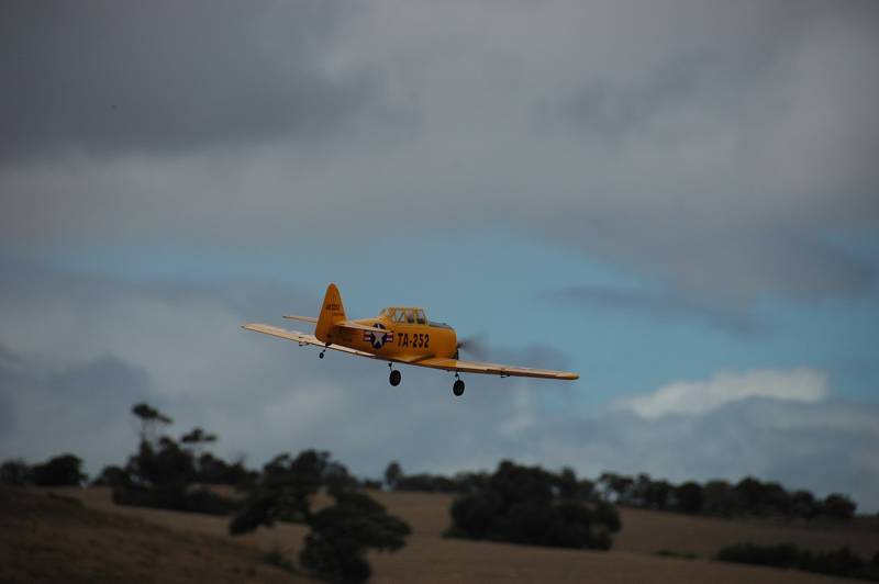

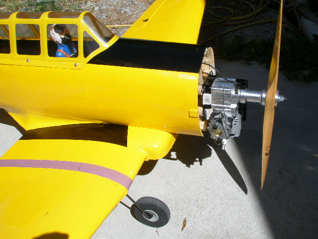

yep Flys great with a 26cc "A" spec XYZ from U/hobbies , 16 x 8 SOAR Prop , CG worked out right on too

great to hear that! looks like theirs no way the cowl is going on. is there?
Old 03-22-2008, 03:17 AM
  #45
SON OF PALEFACE
SON OF PALEFACE's Avatar
Join Date: Jul 2003
Location: Yankalilla, AUSTRALIA
Posts: 552
Default RE: WORLD MODELS AT6 TEXAN 72"
Yeah it will go on just wanted to sort the plane out first , see how it went , and then make a decision whether to stay with the gas engine or if it didnt work out , change to a 120 4st
