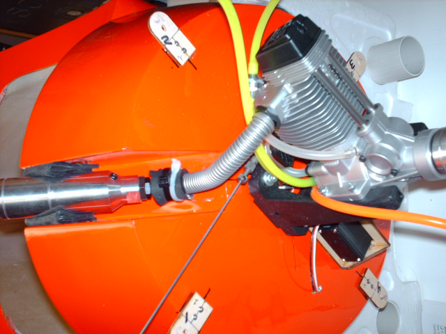

I am getting back into finishing up my GeeBee I got about a year ago
I was wondering how you folks set up or mufflers with the OS F/S 120
I have the 120 with the pump and this seems to be the only way I could
do the Exhaust for this engine.. I think it will be OK. not sure.
I just wanted to be sure from the experts
Jeff

As long as it will clear the belly pan on the wing i say go for it! You will love the way this plane flys. It is actually the most fun i had in years. The only thing i will warn you about is the wing is a little weak for the landing gear. So make you landings as soft as you can.

one thing to consider when using 6 volt packs is that you surely get more torque from the servo, but remember this, servos and gear trains are all built with 4.8 volts as the primary power........we then kick up the voltage to get more power from the servo with a 6 volt pack, and are getting it, but now we are asking the gear train to work much harder as well...............it's best to use servos that are meeting the torque needed to handle the plane in question. think about it, you spend how much on a nice scale plane like the GeeBee, power it with a superb engine like the OS1.20surpassIII w/pump, and do all the expert work it took to get it airworthy, and then take standard servos that most guys will only use for throttle control and try to make them something they are not by using a 6 volt pack?
i'd use no less than S9001's for that plane.......they cost a whole 15 bucks more than 3004's, have better mechanics not to mention superb centering, and will last you longer as well.
it's your plane, but for the investment you have into this, is it really worth saving 50-90 bucks by using servos that are best used in a trainer?

I will say this if you look at the size of the contro surfaces, they reall are not that big. This is no 3D plane. Yes you can put overkill servos on it if it makes you feel better. Even though this is a model of a pylon racer it is really not fast at all. You will find on these forums that there is always someone that will have their own standards and criticise someone for the way they choose to do it. For anyones information i did not use a 6 volt pack for the extra torque i did it for the extra speed. Now I wonder if the servo could not handle 6 volts why do they even give a spec for this voltage? Or why can your reciever handle the same amount of power? I have found that all of the 3004's I use have been more reliable then a 3010 which have 28 more onces of torque than a 3004. The 3010's gear train is so more fragile. This is just some of my real world experience and just passing on what I read here on RCU.
Jeff if you are worried about the 3004's not being enough I would use your digitals on the elevator and rudder and use the 3004's for the aileronsseeinf how the tail will see more airflow.
