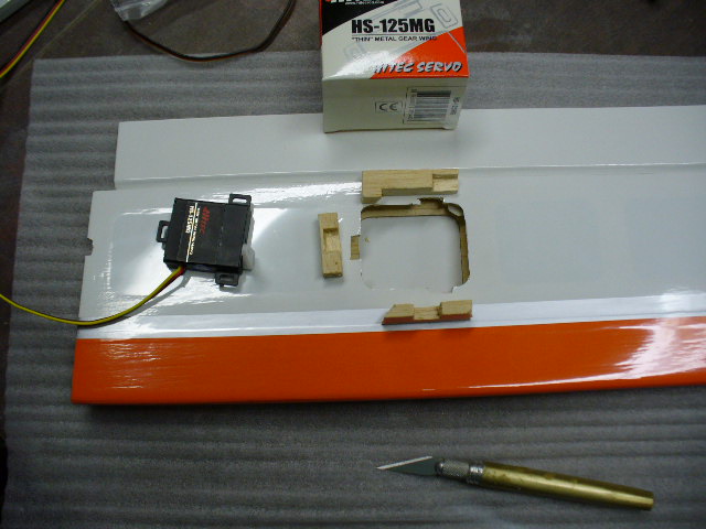

Yes, I can fit a servo to an ARF.Here I fit a Hitec HS-125 thinwing servo into the stab for the elevator.
N.P. wanted two servos in the tail booms to work the elevator, 1 on the side 1 on the bottom.
The purpose of this post is to give others a heads up!

The servo pockets were opened up by 3/64" or about 1 mm in BOTH length and width.
Depth is a fine for a MINI but not for a standard size servo.
So plan on using a Hitec HS-225BB or HS-225MG or equivalent.
Carving out wing servo pockets is no problem a steady hand and and sharp #11 Exacto knife.
Now the throttle and nose gear steerigng are about 4 1/4" deep inside the fuselage.
