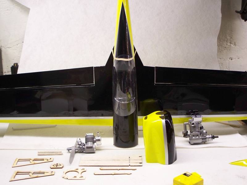

Well, last week I received the Nitroplanes "Zlin EP Electric Brushless Powered Remote Control RC Airplane 90% Built ARF Kit."
The first thing I did was snap some shots of it as I unpacked it so you can get some idea of the kit quality. I was a little surprised that with the exception of the wings, everything else other than the cowl was loosely floating around in plastic bags. The second thing that struck me was that it seemed tiny for something claimed to have 430 sq in of wing. Here's Nitros specs;
Specifications:
Wing Span : 40 in / 1016 mm
Wing Area : 430 sq in / 28 sq.dm
Flying Weight : 45oz / 1300g
Fuselage Length : 31 in / 800 mm
Requirements:
Li - poly : 11.1V ; 1800-2200mah ; Propeller :9"x 6" ;
Out ranner Brushless Motor : 450T Speed ; Control:45AMP.
So I took a few measurements myself and came up with about 255 sq in. Throughout this I was a little concerned about the size of and number of wrinkles in the covering, but I also tried to keep in mind that it is a $69 ARF.

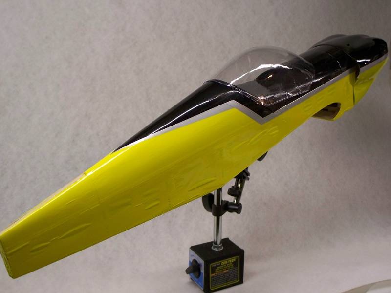

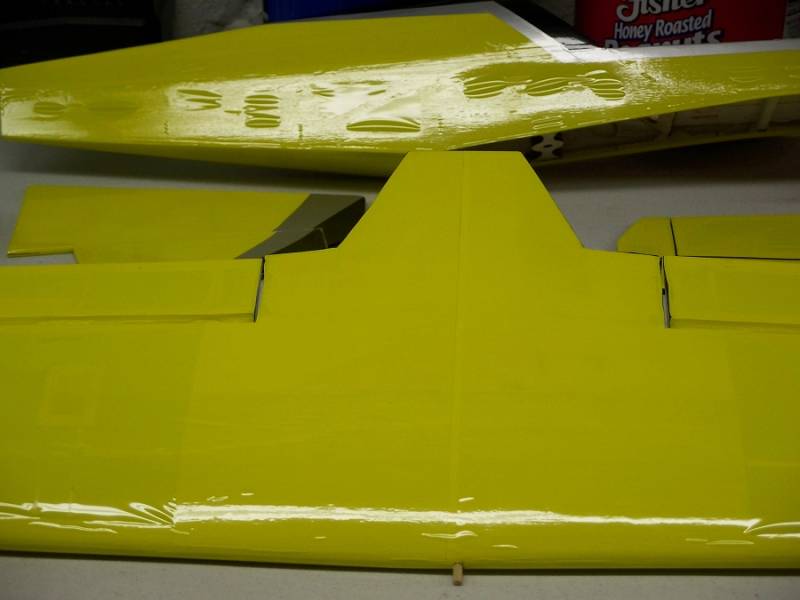

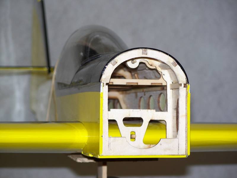

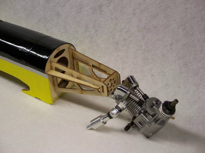

My original intention was to use my Saito .30 in it, and around 9 oz this was looking to be a real strech. So my next move was to loosely assemble it and try to get a rough idea of what it would take to balance it. I got everything in place, the Saito and cowl taped as closely into position as possible... -wow! Not looking too good, so I swapped the Saito .30 for an as yet untried (NIB) AP Hornet .09. Hmmm, still looks like it's going to be a challenge so I took another tack and removed the existing motor mount. This was scary-easy, just a little wiggling here and there and things started to crack loose. In under 5 minutes I had the mount removed and also the floor of the fuselage.
I have since used my heat gun and iron to attack the wrinkles. I'm pretty finicky about wrinkles... Couldn't get them out as well as I wanted.
