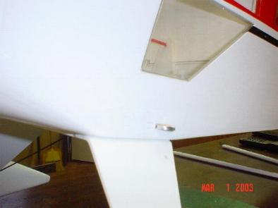

I am having a problem with my new T'craft struts. Today the left strut attachment on the landing gear broke where it attaches to the gear. I am wondering if any one else has experienced the same problem and has come up with a fix.
I am thinking of drilling the strut and epoxy a 2-56 threaded rod into the strut, adding a bit of nyrod to the treads where it meets the gear and attaching a 2-56 lock nut where the threads come through the gear.
Has any one else have any ideas?
Tony

It could be that there is a small amount of flex in the landing gear when you land. I am putting a T'craft together now and plan to put a narrow thin piece of alluminum right through the fusalage
, bolted on top of the L/G and drilled at each end to accomodate the wing struts. It seems to me to be a goofy idea to attatch wing struts to L/G legs. What happens if you make a really fast and hard landing and wipe out yur L/G? ( it happens. Murphy's Law ) Seems like you would do major damage to your wing. I doubt that your idea of using nyrod as I understand it would be strong enough. Even though the T"craft is a docile airplane pulling out of a loop can put a great strain on the wing struts. Not a pretty sight if one fails lol. :idea:

Hangar Rat thanks for your reply. Your approach to the fix is a very good idea. I am not sure if the struts on this plane are functional. H9 says they are but if they were it would seem to me they would have used your approach to the strut set up. We have another member in our club who sometimes flies his T'craft without them but it takes away from its appearance.
My approach to the repair, as you say, will break away on a hard landing or gear wipeout which is what I would want to happen.
The metal used in these struts is brittle so it is only a matter of time before they break.
Thanks again.

Old 04-22-2003 | 10:19 PM
JEanes's Avatar
My Feedback: (11)
Joined: Jun 2002
Posts: 171
From: ridgeway, VA
Default wing strut
done this "before" I flew mine.........."insight" !

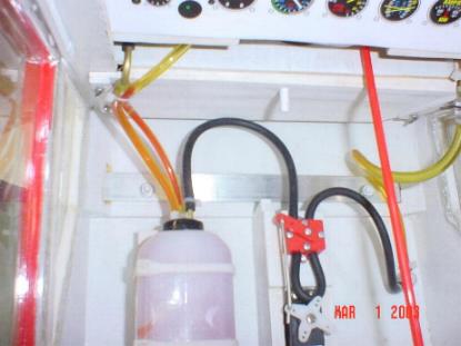

Old 04-22-2003 | 10:23 PM
JEanes's Avatar
My Feedback: (11)
Joined: Jun 2002
Posts: 171
From: ridgeway, VA
Default another pic
.....another......
Old 04-22-2003 | 10:35 PM
Joined: Aug 2002
Posts: 237
From: Naples, FL
Default H9 Strut
JEanes, I like the set up. Looks like an aluminum bar threaded to accept the struts, am I correct?
Tony
Old 04-22-2003 | 11:32 PM
JEanes's Avatar
My Feedback: (11)
Joined: Jun 2002
Posts: 171
From: ridgeway, VA
Default threaded bar
NOPE.....I use a 4-40 cap screw with a nylock nut.
Old 04-22-2003 | 11:40 PM
Joined: Aug 2002
Posts: 237
From: Naples, FL
Default H9 Strut Fix
I like your fix and plan to use it.
Old 04-23-2003 | 12:05 AM
Posts: 149
From: Madison Heights, VA
Default HO Taylorcraft strut problem
JEanes, I think I read of this fix on another forom or topic. It may have been your imput but this fix was not my idea so the credit goes to you. I think it is a good idea and plan to use it on my struts. Thanks
Old 04-23-2003 | 04:02 AM
Joined: Feb 2003
Posts: 60
From: Sioux Falls , SD
Go with the aluminum support for the wing struts and forget about the landing gear struts. They seem to be more for looks than function. By the way thanks JEanes I used your idea hope it wasn't patent. HA HA!
