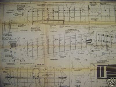

You guys wouldn't believe how much help you've given me too with this little item of interest. A month ago I went to a yard sale and bought an old Great Lakes 2T-1A (original 1933 version) that was kitted by Scale Line Models in 1961. I have to assume the plane's about that old, covering was totally rotted, tires (that came with the kit) were actually flat, it had been sitting in one place for so long.
I've got it about 1/2 restored now. All (*ALL*) glue joints were re-enforced, had to make new outer struts, a lot of work in the engine compartment, new STRONGER flying-wire anchors, and a bunch of other things. I'm about to mount a new engine in it (OS .40LA that works wonderfully) and I've found a fuel tank in Tower that's short enough to fit in the engine compartment and still holds 8 oz. Will be re-covering it with silk (more likely with Dave Brown Skyloft) and SIG dope, with the aim that it'll be flying by June.
I've gotten a lot of help here on RCU with placing the balance point (CG in most lingos) and a lot of advice on how to fly it and what to expect, but I've been wondering about that top wing's incidence - which is where you guys helped a lot.
Very recently another kig just like mine sold on e-bay and I managed to copy some pics of it as it sat in the box, including several pics of the instructions. Unfortunately, the pics are rather fuzzy and they're not nearly the help I was hoping they would be.
However, I'm planning to semi-recreate one of the original 2T-1A's as it now stands, and I picked NC841H. Prime reason for this particular plane, even though it has the newer engine with prop on the top of the cowl, is that according to John Duncan (present owner of Great Lakes Aircraft Manufacturing) it has the correct colors in the correct color scheme for the 1933 plane. I also have his permission, in writing, to recreate the Great Lakes logo on her side.
Anyway, I'm hoping mine flies better than yours is reputed to. I know that in the past she's flown a lot - and she had a tow-line mounted, probably for carrying gliders, so she must have flown pretty well at one time.
So, I thank you guys for the info you've imparted - it's truly appreciated.
I'm including a couple pics of the original kit as it was on e-bay and a pic of the full-size 841 today, just for reference.
Dave
