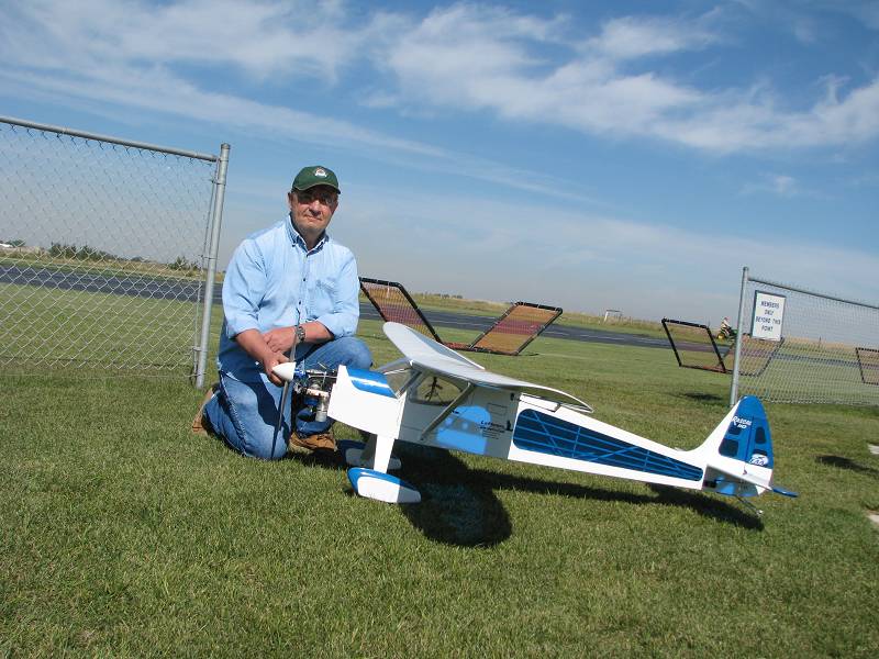

Old 08-18-2008 | 06:20 AM
king_arthur1953's Avatar
Joined: Mar 2008
Posts: 427
From: Searcy, AR
Default RE: 110 Rascal gas engine install
I have finished mine for the most part. I am still working out the best engine prop combo and the linkage on the engine but other than that this is one great flying bird. Man can she float. Makes some beautiful loops also. Here is a pic. I will get some in the air soon I hope. The pics came out small so here ia a direct link to phtobucket.

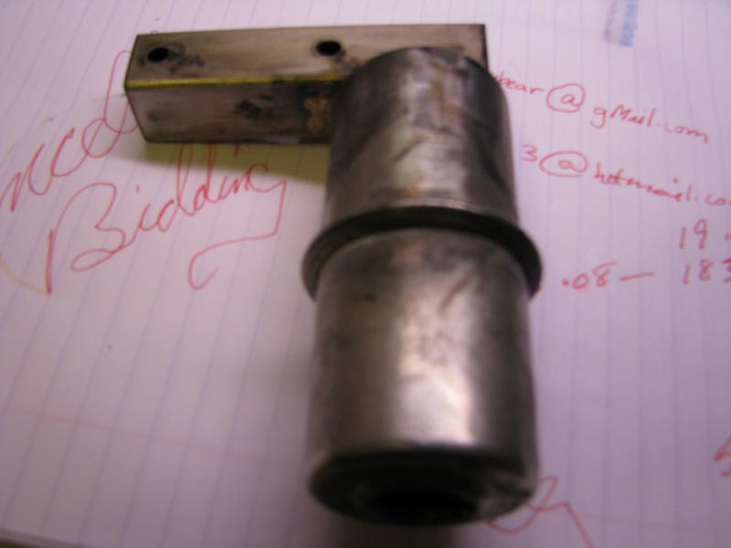

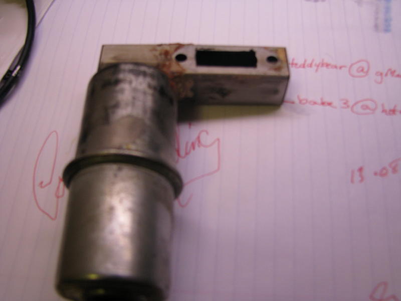

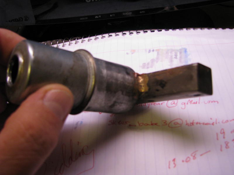

Old 10-12-2008 | 11:30 PM
My Feedback: (15)
Joined: Oct 2004
Posts: 79
From: Calgary alb, CANADA
[Ok
You will need about five inches tubing and one lawn mower muffler from Canadian tire or lawn shop.
this muffler is made from an old chair frame or buy a piece of 3/4 sq. tubing weld cap both ends
cut exausty outlet 1 by 3/8 inch
Drill bolt holes for attachment to engine
Cut hole in bottom for muffler attachment.
Before welding check for fit as Rascal does not have any extra space off to the side.
Pictures below

Old 10-13-2008 | 01:15 AM
Joined: Dec 2002
Posts: 1,986
Received 7 Likes on 7 Posts
From: La Paz BCS, MEXICO
Sparkey, I like your muffler! 3/4" square steel tube, and was the nipple end of muffler 3/4" or 1/2" ? Did you cut out a portion of side of nipple to allow gas flow thru the side or was the nipple just barely inset into the square tubing?

Old 10-13-2008 | 10:36 AM
My Feedback: (15)
Joined: Oct 2004
Posts: 79
As the muffler was made for me I am try to see inside
Looks like the muffler hole was enlarger to just short of the side of the sq. tubing.
This muffler has baffles in it that could be removed for more power if needed .However it seem very good noise and power wise.

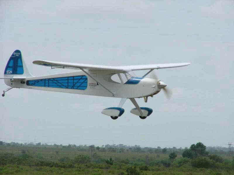

Old 10-13-2008 | 09:51 PM
Joined: Mar 2007
Posts: 308
From: Rio de Janeiro, BRAZIL
Sparkey and all,
I didn't have any lawn mower muffler. So, I used the chair frame for the whole thing. Let me know what you think and if it will work fine.
Thanks Sparkey, for the neat idea!
Flavio
