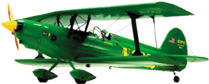

I would the recommend the Bipe MK2 from Aviomodelli. Best flying bipe I know in this size, very good with a 91FS - Saito 100 should be perfect!

I have just testflown a Bipe MK2, and it flyes good on a OS FS91, I would bet it would be even greater on the 100. This bird is not an ARF, but something inbetween a kit and a ARF. It builds rather quick, once you got the manual figured out. Its stable as it gets on ground, and is a great in the air as well. If I was to make another there is several mods I would do, lightning the tail is needed as the bird came out tail heavy. Anyway, this bird is higly recomended.

The Bipe MKII is closer to a ARF than a kit, but there is somewhat more work than the average ARF. The fuselage is molded plastic, and the wings are planked foam cores. The worst part is the manual, but if you read trough it several times there should be no problems putting the Bipe together. I have several ideas how to lightning the tail, as a matter of fact I would love to do another, as I could make a great bird even better. If you decide to go with this Bipe, feel free to mail off board for assembly details\hint\tips\mods.

Ive been looking at the AVIOMODELLI Bipe. Is it pre-covered? and is green the only color choice? The on line catalog shows a green one and a yellow one.
How much time is involved in construction? And is the manual in English? (this is an Italian made model)
Thats a saito 100 in that CG Ultimate and it's not near enough.
Now obviously I knew it called for a 120 on the high end but I cut a lot of weight out of this kit and thought the 100 would suffice, plus I just happened to have one in the shop.
With the low end being a 91 and the reduced weight the 100 is not enough for this 60 size aerobat. Try the Dave Patrick Ultimat 40 (currently backordered 6 weeks) or that AVIOMODELLI.

The Aviomodelli Bipe does not come colored. It is white. The fuse is some kind of plastic and the wings are covered with some kind of covering. You can paint them any color that you want. I am trying to decide if I want to buy one myself. they will be in stock on Friday.

Just ordered mine, (w/ wire kit). Intentions of making it look like the green one in the catalog.
Should be a gorgeous airplane. Hope it flys good.
