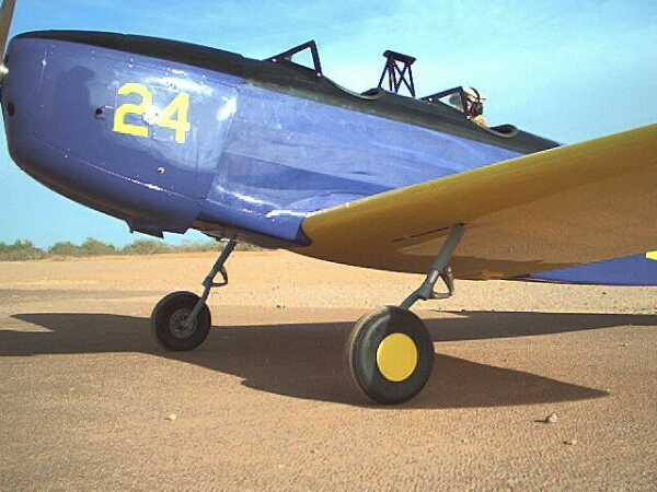

Does anyone have a Great Planes PT-19 with Robart Robostruts? Robart lists a set for the Dynaflite PT-19 and another set for the H9 PT-19. Will one of these sets work on the Great Planes PT-19?

According to Robart, the H9 PT19 Struts are interchangeable with the GP PT19.

I just finished installing a set of the H9 (Robart # PT19HA9) struts on my GP PT19. Very easy conversion and very clean setup (took about 30 min., and I work slow). The H9 and GP both have 5mm landing gear wire so they fit perfectly. Be careful, the Dynaflite has 1/4" legs. I don't think you could make them fit correctly. Another consideration is the weight of the planes. The Dynaflite weigh about 16 lbs, the H9 about 13 and my GP 10. I talked to the guys at Robart and they think the H9 springs will be ok, but if they're too stiff I can get softer replacements from them. I also went to 4" Robart wheels. I've always thought the GP's 3.5" wheels looked too small and the H9's 5" looked WAY too big. I'll let you know how they work after the weekend, with pictures.

Got to fly with the new Robostruts this past weekend. Very Cool. They look good annd work great. The plane is a lot less likely to bounce now. The springs might be a little too stiff, but I'm going to reserve judgement for a while and get some more flights in. The biggest problem so far - watching the struts work and NOT watching the plane!

Dugster, struts look great, I think the sping action will get better with more use at least that is what some of our PT19 flyers have told us.
