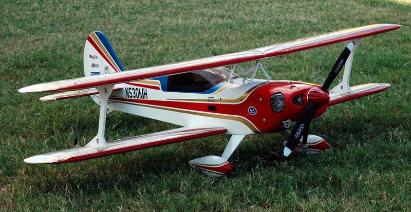

Here is my Skybolt with a 1.20 AX. I had a pitts muffler when this picture was taken, but I now have the stock muffler. Just use the adapter offered by OS to turn the stock muffler 90 degrees like a pitts muffler. The stock muffler without the noise baffle runs better that the pitts muffler. This is a great combination. I have hundreds of flights on this plane and it definitely has unlimited vertical.

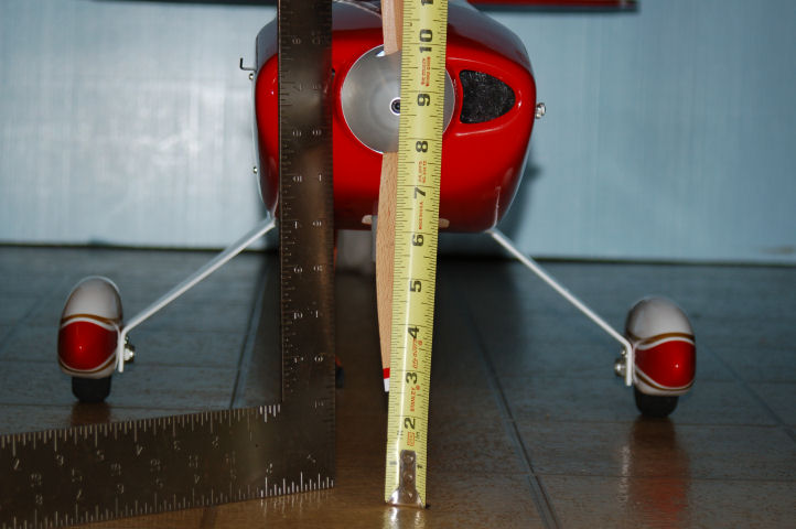

My Skybolt has just under 9" from the shaft to the ground.
It's gear isn't the stiffest you'll find on most 8-10lb models. If you land with the prop turning, you need to consider gear flex. Over the years, my gear has relaxed a number of times and needed straightening.
