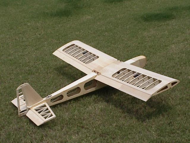

Now my Tower 40 Trainer resembles more of what I saw in your photo: After a minor crash I totally stripped it and rebuilt it. I also did flaps, bolt on wings, and I also removed the plastic end caps on all surfaces. Must admit I'll probably never use the flaps again on the Tower 40. Tried it once....talk about floating in with a balloon landing!

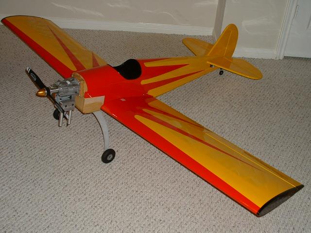

By the time I got to the Spacewalker, I was trying very hard not to go nuts with the mods. Still, I did away with the wing-mounted wire gear and bolted a set of GP 1/4 Giles gears. I also replaced the tailwheel with a Ohio Superstar unit and mounted dual elevator servos under the stabs. G23 is the latest choice of power plant. Here's a pic of the progress so far.

I'm expecting finally to finish it a couple of weeks from now. I originally had a Magnum 1.20FS mounted on the Spacewalker, but by the time I added the weight of the motor mount to the 1.20 FS, the G-23 converted to CH-Ignition only weighed a few Oz. more.
The Spacewalker typically needs nose weight anyway, and even with the plastic wingtips left off, the wing area has over 1,000 sq.in. At estimated 10lbs RTF, my Spacewalker should still have a fairly light wing loading of around 23 Oz/sq.in. - not too bad. As of now, the plane balances perfectly with the 2 elevator servos mounted at the tail.
However, I'd have to say using a gasser in this size model is borderline okay. The Spacewalker worked because it has such a short nose moment. I will let you know when it's finished.
