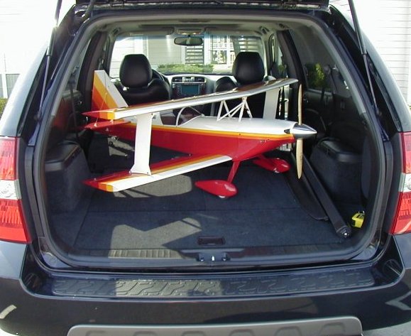

Steve,
Just for info. My CG Ultimate, assembled, will JUST fit in my suburban if I put it in tail first and at an angle. Ever since I found that out, it has been a lot more fun to fly. Yes 15 minutes to assemble is not that bad; but it's the PITA factor I hate.
Steve
PS: I made an overhead rack to hold wings and some PVC racks that allow me to stack planes on top of each other. I can put two 1/4 scale and two normal size planes in my suburban now if I really want to. but ever since I got the Ultimate it's the only plane I ever take anymore.
Steve

The CG Ultimate is definitely just the right size for transportation. I never had to remove the wings on any of mine when going to the field. Actually, even my DP 1.20 size Ultimate fits right in my SUV which is an Acura MDX. I have to put it in tail first diagonally, but I've had it AND my Goldberg Sukhoi both in there at once (The wing was off the Sukhoi!)
I have the direct Connection Ultimate ARC.It stands 19" with 3" wheels.It's a nice plane.Hope to fly it this Sunday for thr first time.
