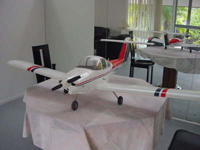

G'Day Matty,
Attached a pic of the VMAR Tomahawk.
Flies very well, although mine is a bit under-powered with a T.T. 54 4C. No big pitch changes with flap.
Even with a hefty nicad (4400 ma) up front for the on-board glo, it still needed a chunk of lead to balance OK.
The nosewheel steering needs only a little travel as it's not that far ahead of the mains.
I also built the Airsail version (kit) which took a fairly long while to complete. Looked nicer but was fiddly gluing all the control surface skins in place and getting the elevator nyrod set up as it runs up inside the fin.
The VMAR instruction book shows the same elevator control system as Airsail, but as supplied, the VMAR aircraft has a check out in the side of the fin to accept a servo with the extension cord already run through the fuse.
Atached a few pics.

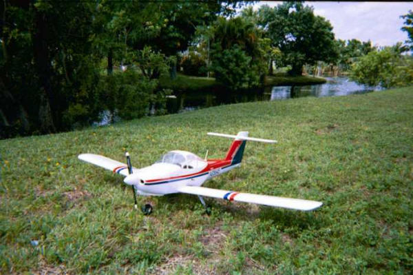

Here is my AirSail Tomahawk, came from 1 of the very 1st kits made. Powered by a Satio 56.
