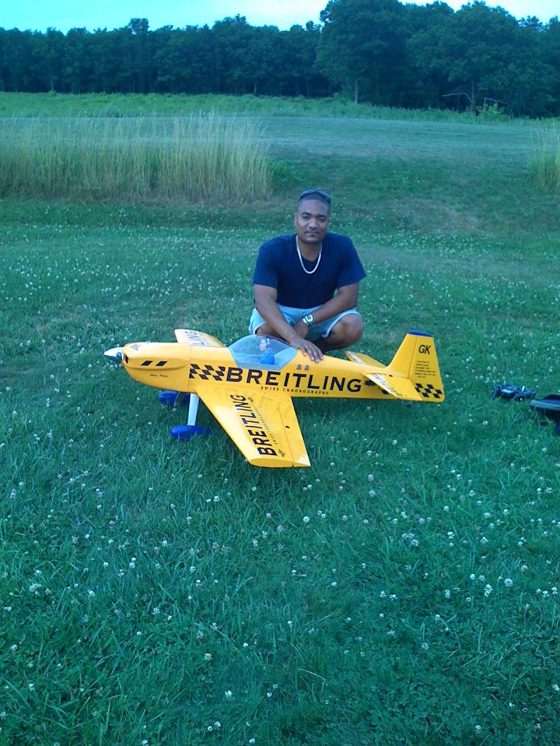

Yep, Just got back. Actually doesn't float too bad.
I love it! Thanks for the help guys!
Pete

Good job. Always a good feeling to get that first flight out of the way, isn't it.
