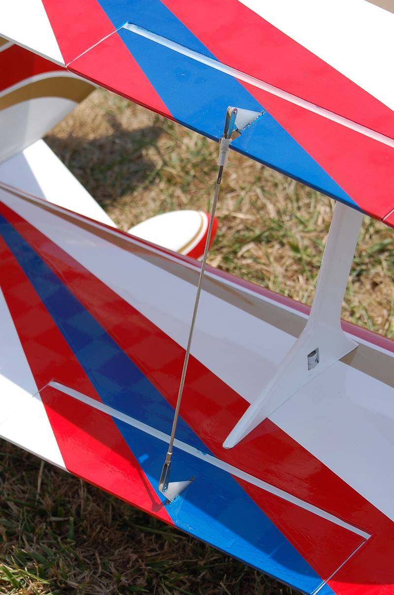

You don't have to, but it is easier and more accurate to simply adjust your rigging.
Use the farthest hole on the servo arm if the pushrod isn't out there already. It takes only about 20 seconds to move a pushrod connection.
My setup right now is with the pushrod in the next to farthest hole in the servo arm. It goes to the 3rd hole out on the aileron horn. And the airplane rolls quite fast. I've had the pushrod in the 2nd hole out on the aileron horn, but it was too fast for my wishes when using high rates. I'm betting you'd have liked that roll rate.
Thanks for bringing up this question, because it made me go look at my rigging. Since there are farther out holes on both the servo arm and aileron horn, I can probably move the pushrod out equally on both at the same time. Why do that? Same reason you want to change throws on the airplane instead of in your radio. It's more sensible to do it that way. For accuracy and leverage.
BTW, if you really want more effective ailerons, you need to read up on the problem the ARF rigging causes with the Skybolt and most smaller ARF biplanes.

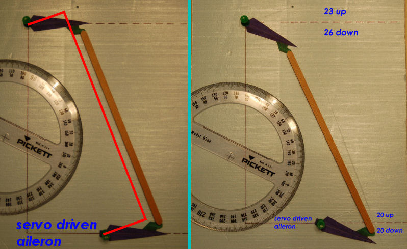

The hardware and design for connecting many of the smaller ARF's ailerons is flawed. It uses whatever horns are used for rudders, elevators, and such.
What you wind up having is 3 different throw amounts every time you move the aileron stick. You got 4 ailerons and two go the same amount, while one of the upper ailerons goes a different amount than the lowers, and the other upper aileron goes yet an entirely different amount than the other three.
Say you want 20 degrees of aileron movement. What you get is the two bottom ailerons going 20 degrees. Kewl. But one of the upper ailerons winds up going 23 degrees and the other goes 26 degrees. Sound sensible to you?

Were you missing something?
Yeah, the way the model flies when all 4 aileron throws are the same.
The roll rates aren't going to be different clockwise to counter clockwise since the inequality works the same both ways.
What does happen is that having all 4 ailerons throw the same gives 4 outer wings that reach stall AOA more nearly equal. And it also happens with the stock rigging that one of 4 will have a lot quicker stall. You could say that the bad setup creates washout on one of the pair on one side while creating even greater washin on one of the pair on the other side, while no washout or washin is created on the lower halves at all.
