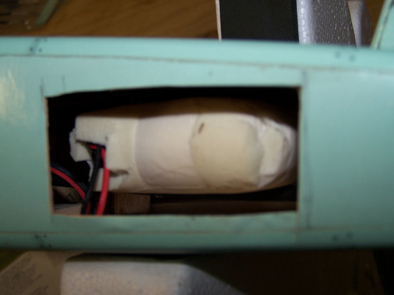

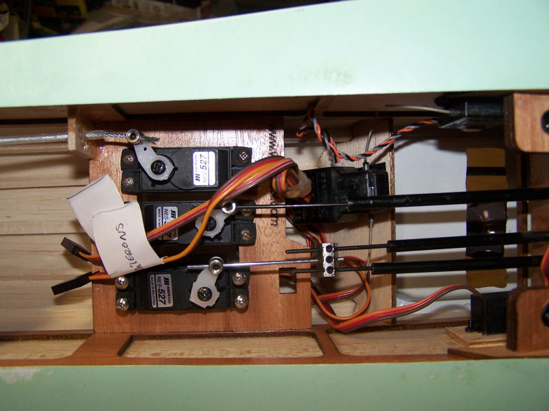

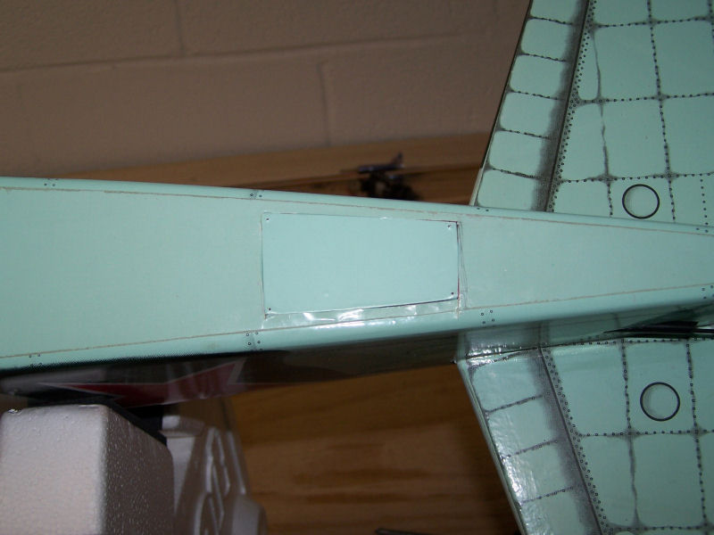

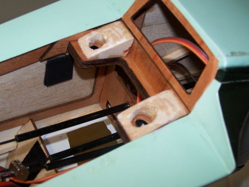

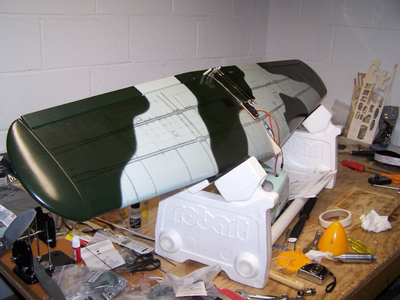

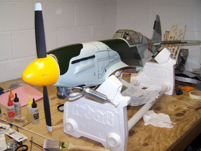

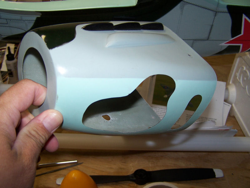

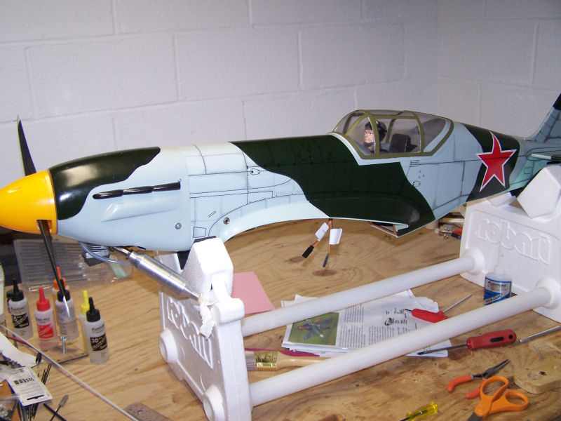

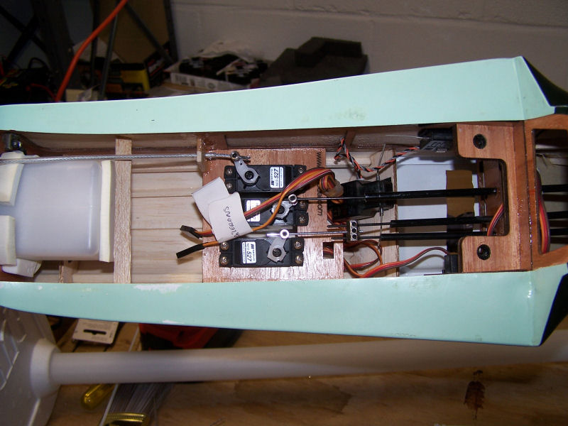

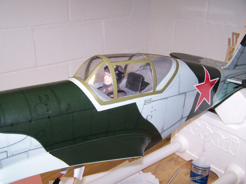

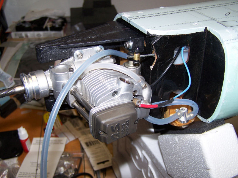

Hello All,

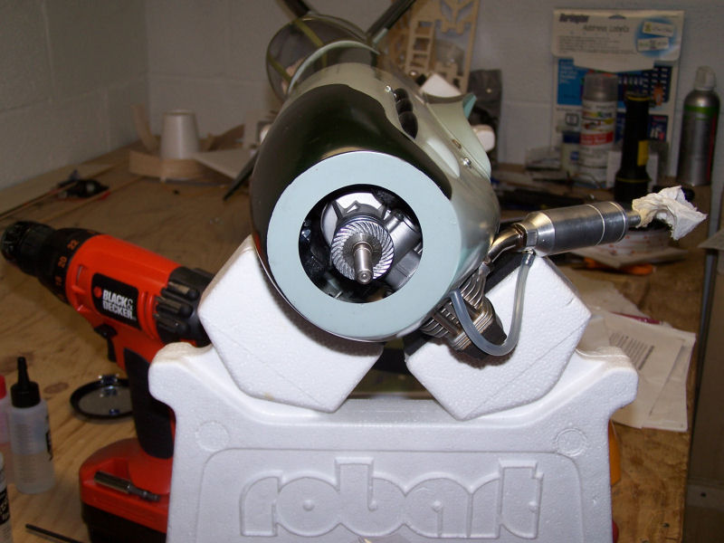

I have some pictures of my build, it was a very straight forward build, easy to follow instructions even a newcomer will be able to put it together, instructions recommend a 2 stroke .40 to .46 or a 4 stroke .60 to .70, so I decided on the 4 stroke, an OS .70 Surpass II.

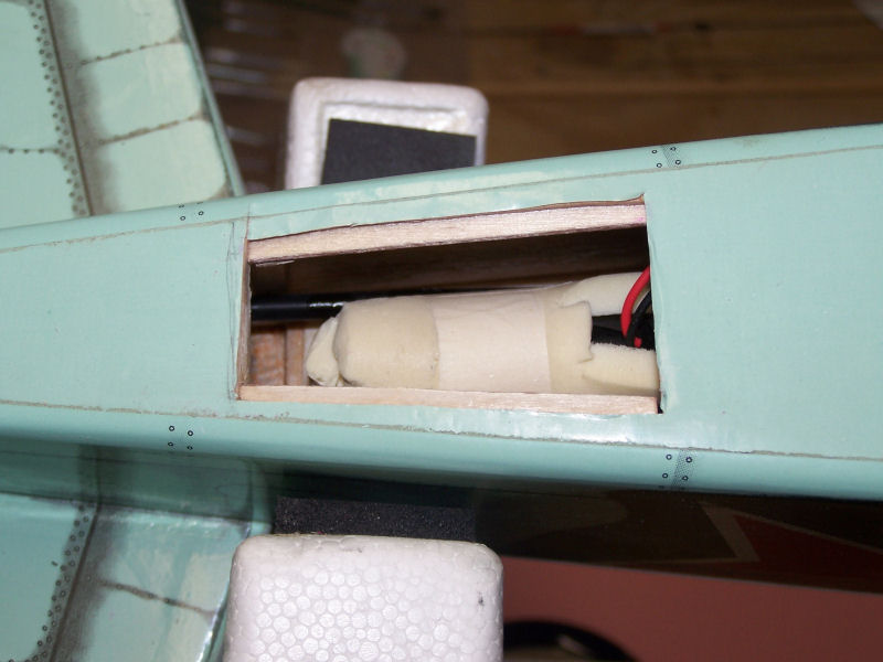

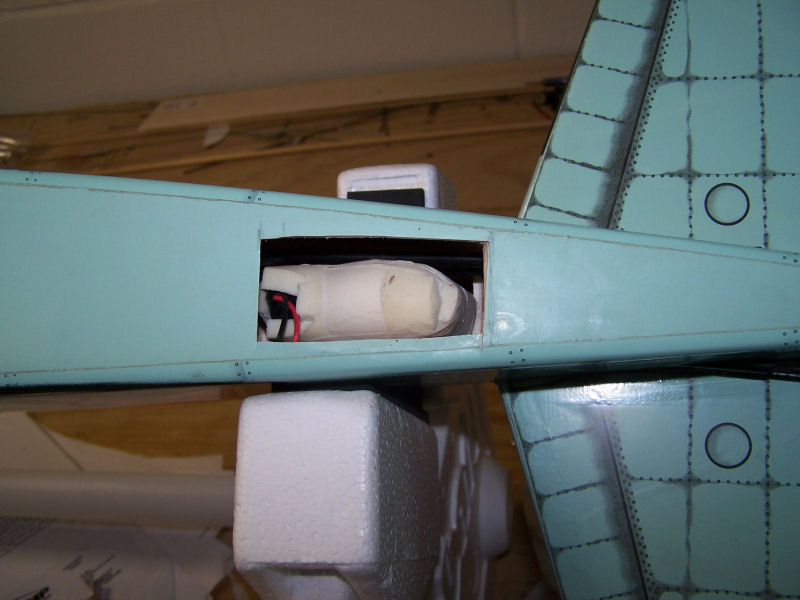

With the 4 stroke it was VERY nose heavy so I decided to install the battery plus about an ounce of lead all the way on the back.
I made a hatch under the fuselage, I glued some balsa in front of the battery so it would not move forward and there is velcro as well to hold it down...check out the picture. It balanced just a little bit nose heavy, and it flew great.
A couple of changes, first I changed the fuel tank to a Hayes 12 oz, the supplied tank looked very small, second I added a couple of spacer blocks under the wing hold-down bolts.
It is a very easy model to fly, I am having lots of fun with it, plus because it is not as popular as the rest of the warbirds I am always being asked..."what is this?"

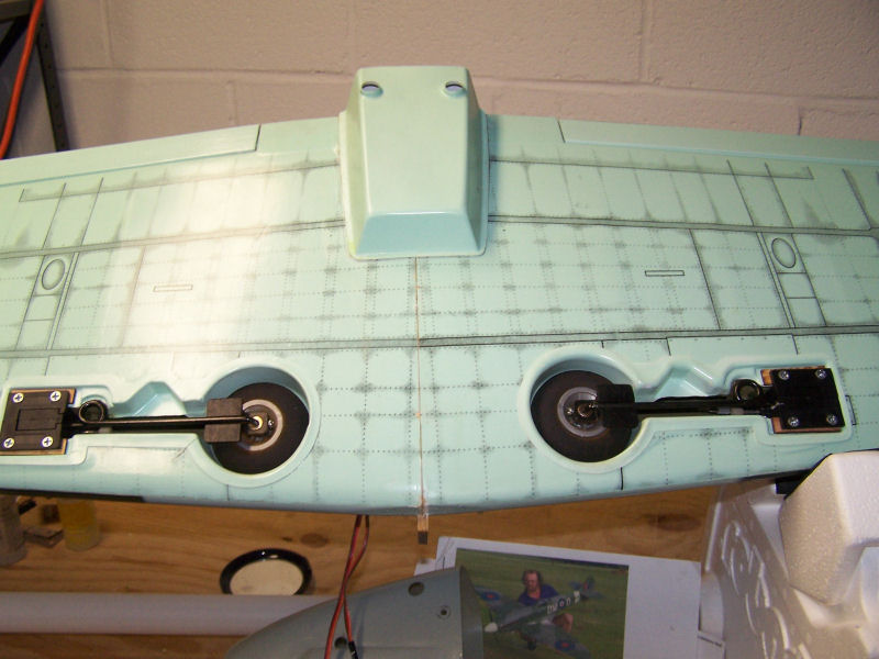

That is one fine looking aircraft! What is the overall weight ready to fly? Also, are those the stock retracts? If so, are they very good? Thanks, Rich.

Excellent! I'd be interested in hearing about the retracts also. Does it fly heavy, like most warbirds? The last time I saw a model Mig 3 was a scratch build about this size in 1980. It flew exactly once, entering a tip stall on its first turn and spiraling in to destruction. I believe he spent over a year designing and building. ARFs have their advantages

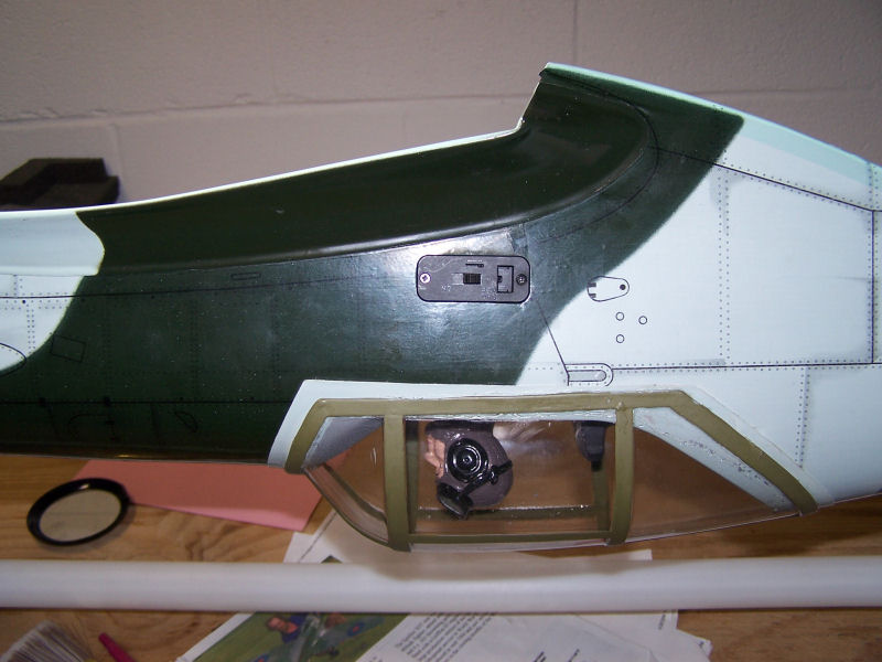

Looks very nice! A couple of questions:
Did the stainless steel socket head cap screws come in the kit?
Did the interior wood come varnished from the factory?
Old 08-19-2008 | 11:56 PM
My Feedback: (68)
Joined: Aug 2005
Posts: 28
From: CLARKSTON, MI
Default RE: VQ Models Mig 3 Build
Hi all
The flying weight is about 5 to 6 lbs, unfortunately the retract are optional, they cost around $29.00 and I think they are good enough for the job. The airplane comes with fixed gear.
I must say that this airplane flies excellent, I must say that is my best flying airplane in my hangar, it beats my Hangar 9 P-47 60 size.
It is semi-scale so the wings do not look like the scale airplane.
I purchased new hardware, and NO, the airplane was not varnished from factory, I did that to fuel proof it.
I still have to upload a picture od the finished product, will do that soon.....
I am just having lots of fun with this plane.

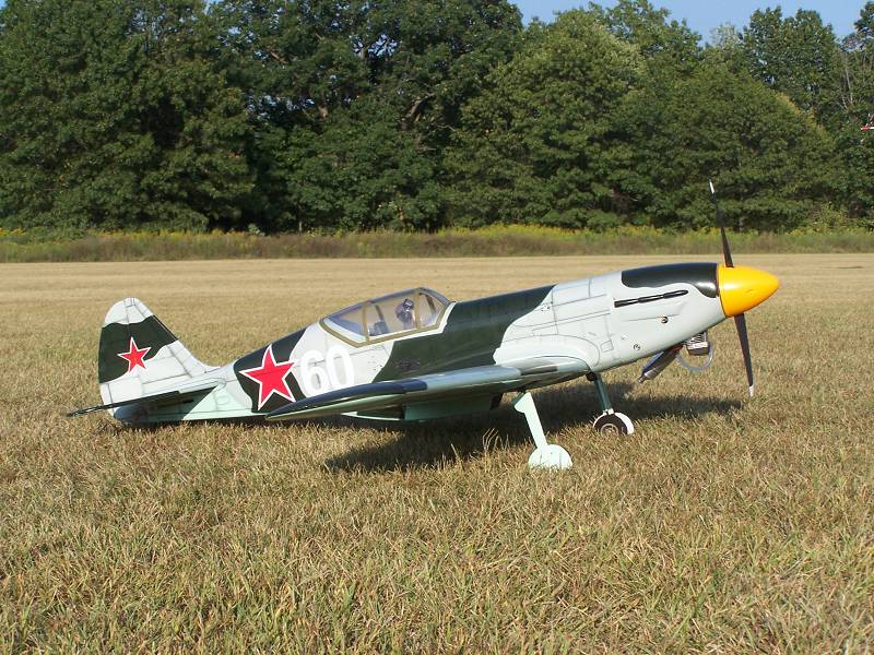

Here it is

Old 05-28-2009 | 12:23 AM
tIANci's Avatar
Joined: Jan 2004
Posts: 10,489
From: Kuala Lumpur, MALAYSIA
<span style="font-size: larger;"><span style="font-family: Comic Sans MS;">This plane looks nice, just needs a better colour match for the cowling. She is one warbird that does not easily stall and will not nose over on landings. She is a smooth plane to fly.</span></span>
