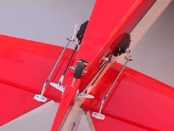

The rudder setup looks wierd...is it a servo??? or bell-crank back in the tail with the arms sticking out the side??? Don't pull-pull rods have a tendency to bind?? Looks like the geometry just isn't quite right on it...or is it just me??

Yes, there are three servos in the tail. There is a small access panel just in front of the tail wheel. The rudder servo sits facing towards the bottom of the plane with a long arm sticking out bth sides of the fuseladge. The rudder is a pull pull setup with short wire pushrods instead of cable.

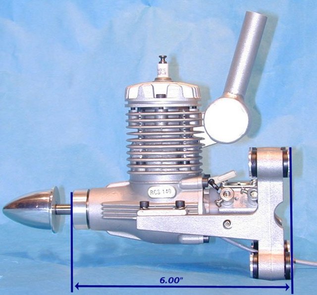

As far as balance, I had to cut the factory motor box off the firewall to fit my RCS 180 (it was too long to fit in the cowl when mouned on the end of the box). If you do have to cut the motor box off to fit the RCS 140, realize that in doing so you are moving the weight closer to the CG which will make the plane balance tail heavy. If it does you might have to mount the rudder servo under the cockpit area on a pull pull to balance without lead. With the motor box cut off and the ignition and battery mounted to the fire wall I was able to balance mine perfectly with all three servos in the tail with no leadweight.

The 1.80 is 7.3 inches long with the stock radial mount tabs..
The 1.40 is 6 inches even..to the hub..is that going to be too long? I can move it back in smaller incriments if I drill a hole for the carb in the firewall...and let the carb extend into the box...yet still have mounted to the beams...nice thing about the 1.40.

I just went out to the garage and measured my Saito 180 with J Tec mount as it was mounted before I cut the motor box. The distance from the from the front of the motor box to the front of the cowl is 6 1/8" (plus or minus 1/4inch depending how you adjust the cowl). It should be a perfect fit! The more I hear about your RCS 140 the more I think I should have gotten one instead of the RCS 180. The RCS 140 will be the same length as my Saito 180 with mount. With the Saito 180 I needed one strip of lead weight to balance with all three servos in the tail. Th RCS 140 is a little heavier than the Saito 180 so I am betting it will balance about perfect.

Thanks for measuring!! That's Good news...don't have to hack up the motor box.

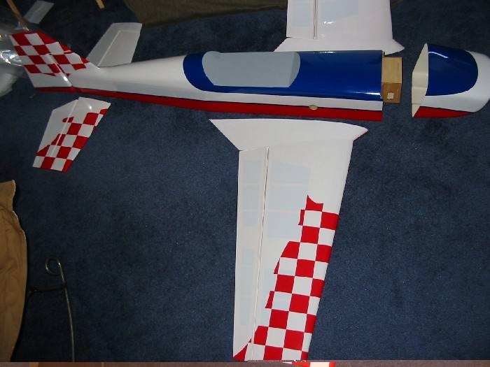

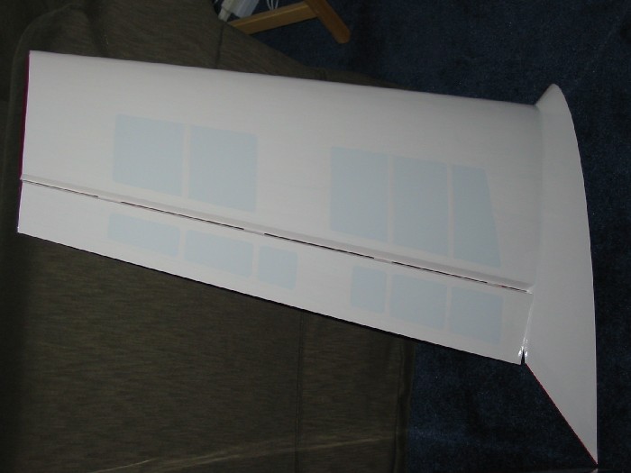

Just took 15 minutes while on lunch to un-box some of the plane and snap a couple photos....
This plane looks very well built, and pretty dang light!
I see what you mean about the covering being semi-transparent, but it doesn't really bother me ....looks kinda cool in a way.
I can tell I'm gonna have some fun with this one....
Here's a shot of the fin/rudder without flash...you can see the transparency....
Gotta love the brown truck...
