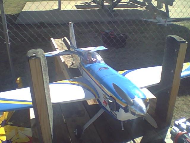

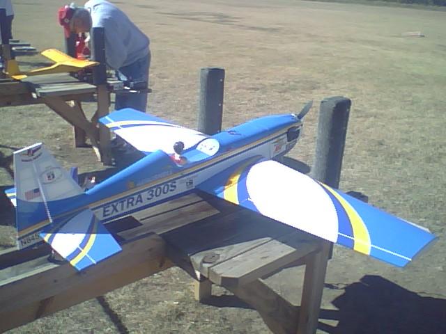

hostile77
Join Date: Mar 2008
Location: lewisville, TX
Posts: 7
Default RE: Seagull Extra 300S .75 ARF?
Here's some pics of her on the stand...
