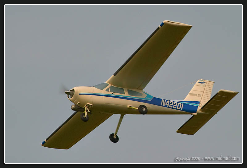

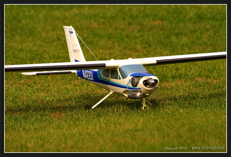

I had one of these with an OS .61 in it and put over 300 flights on it before losing it due to a bad Rx battery. Great plane and tough as NAILS. Hard landings, no problem, cartwheels on a grass field, no problems. This is one tough airplane! I put the whole thing together with thin CA and didn't make any modifications at all. Get it! You'll love it!

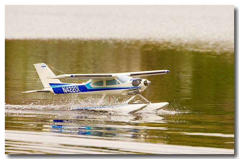

I posted about this plane in another thread, trying to find out who in the US still sells or distributes them, and can parts be found. I. too buckled the wing on one side at about mid span, from a hard water landing (well, crash, really, straight in from 100 feet), and the steering arm on the nose gear has broken (I use both floats and gear on it and fly it with a Supertigre .61)
Like Meesh said, tough as nails, and the material makes it an ideal water plane.
