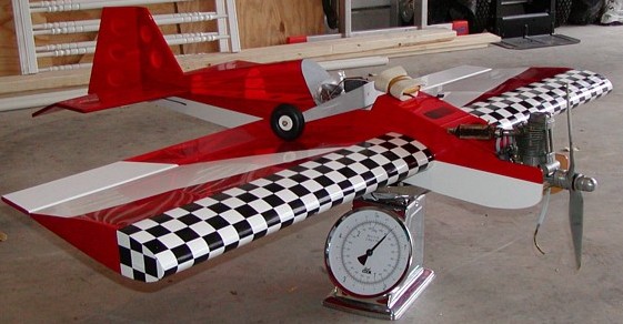

Old 03-19-2002 | 03:58 PM
Posts: 21
From: San Antonio, TX
Default Pizazz Engine
I just weighted mine. Come in at 5.5lbs. It might be an ounce or two over that once I glue the canopy on.
Attached is a picture. The scale is a 5lb scale, so the needle went around once already.
Here is the full size picture: http://www.sanantoniorc.com/members/P3192604.JPG

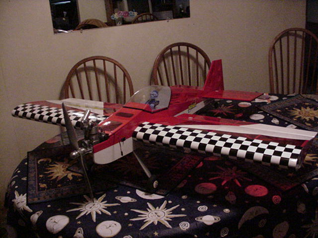

Old 03-19-2002 | 05:47 PM
Posts: 66
From: Abilene, TX
Default My Pizazz
Here's mine. Check out the pilot!!! Mine weighs right at 5 lbs

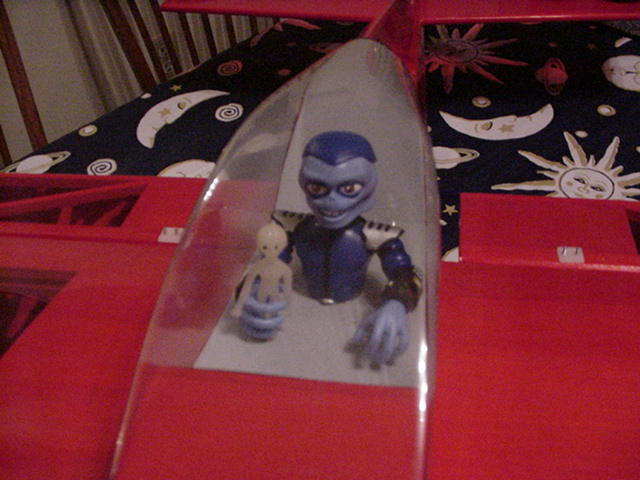

Posts: 66
From: Abilene, TX
Default Pizazz Pilot
Better shot of the pilot!!!
