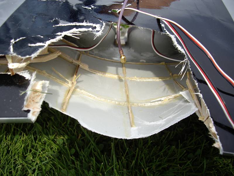

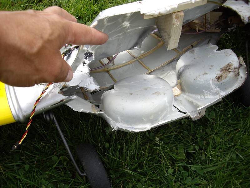

I have bought last winter from NitroPlanes a CMP AT-6 Texan and I did 6 flight of 10 minutes. On the last flight I was straight and level and the fiberglass mid-section of the wing fold in flight. The tip off each wing almost thouch together. Nothing I could do to prevent this because it's impossible to see what's inside that portion off the wing. It is simply and baddly built because there is no plywood former and even No main spar, only cheap balsa ribs cover with fiberglass.
This specific section is structural, it has to take all the weight and stress off the aircraft and it's the weakes one. Of corse my Zenoah 26ei was badly hurt in the crash like other parts. I’m realy sad because I had nothing to do whit that crash and also because that plane was flying very well. I did send emails with pictures to CMP and they simply dind’t reply to me. Nitroplanes told me that there was nothing to do and that the were sorry, WOW! That is what the call customers support!

Wow, that is both sad and amazing...no wood where you need it and it looks like some 1by 3 blocks just thrown in there to beef the wing mount... They were definately trying to rely to much on the surface strength of the glass wing surface, I hope you can come to an agreement with them...But I have always heard nitro models was a RISKY DISTRIBUTOR for service.... Unless I am wrong didn't this kit used to have a traditional builtup wing? I have one of the big CMP pro zero's from that same line of kits(older) and its built up...

Yes! But it's very hard to reenforce that wing box whitout breaking what's inside. It as to be made at the factory.
