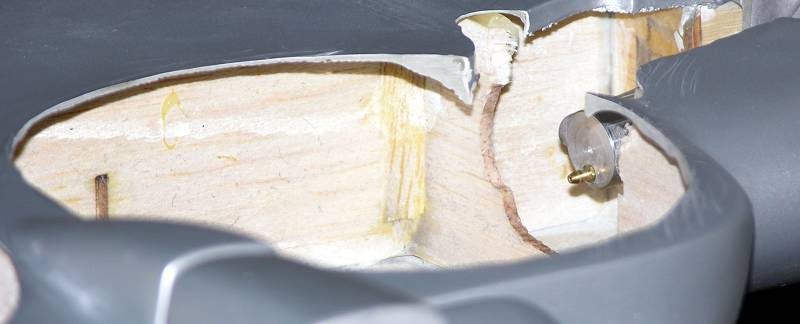

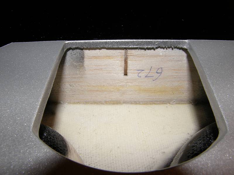

Old 11-22-2008 | 10:57 AM
  #31
Joined: Mar 2006
Posts: 57
From: Clarksville, PA
Default RE: Very Bad, CMP AT-6 Texan
I have been looking at the pictures of the center section, and finally have had a chance to take some pics of the AT-6 that I am in the process of building. It looks like there was no balsa spars in the center section that failed. On the fwd and aft side of the wing connection tube on mine, there is a full length front spar. It is balsa and I have not checked the thickness. Looking fwd through the hole aft of the outer wing, there is another spar. I can't tell if is is one piece. From the pictures of br310's, it appears that the spars are missing. If that is the case, Nitro Models should replace the AT-6. At this point, I think that you might send pictures to CMP, not Nitro, and see what their response is. http://www.cmpairplane.com/ [email protected]
I hope that this might help. Please let me know if I am missing something in you pics.
Ken

Ken,
after seeing the pictures at the beginning of this thread I wouldn’t fly this, main spar which connects the wings in the middle should be of ply wood minimum if not aluminum tube, and if its aluminum tube see where its being held.
Balsa spar is good for trainers or light airplanes not for something like 10-15 lb.
Your plane, your motor and radio system, your friends around.
It’s a mistake of second order……
you drive a car and get a flat tire and stop the car.
Mistake of first order happened because you didn’t know that you can get a flat tire.
Then you decide to continue to drive the car with the flat tire.
That was mistake of second order, you knew that there is a problem but you choose to ignore it.
What is the difference? If you stopped to fix the flat tire you continue to drive normally, if you driving with the flat tire you can cause an accident.
Alex

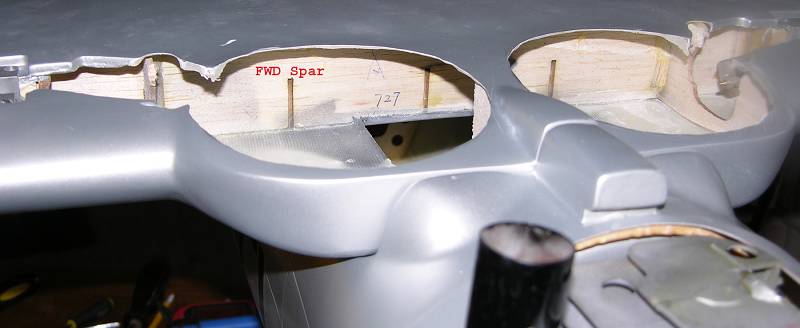

Old 11-22-2008 | 08:18 PM
  #37
Joined: Aug 2004
Posts: 151
From: hendersonville, TN
i dont think all the cmp texans will have this problem im with ken41 looks like your center section is missing all kinds of parts. mine feels very strong with front rear spares and alot of ribs

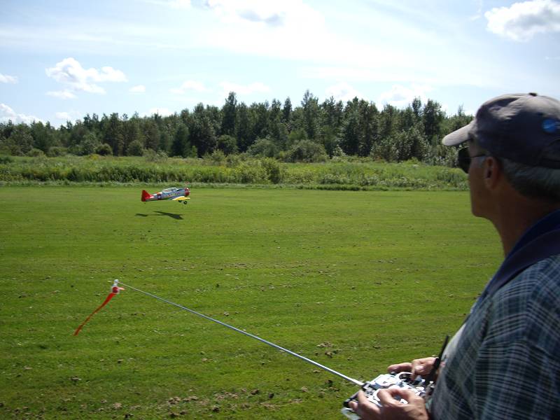

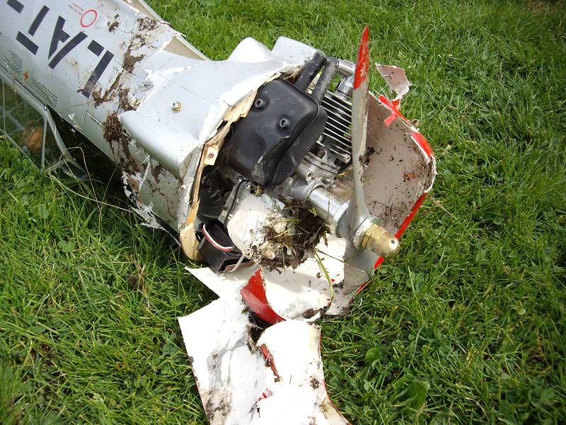

  #38
Joined: Nov 2007
Posts: 21
From: St-Nicolas, QC, CANADA
I'm sorry Charlie, but I dont"t, everybody were looking up in the air and could'nt belived what was going on. I was also the only one flying a that time. So I had everyone attention [sm=regular_smile.gif].
One wing as no injurie at all, the other one can be fix very easely, but the fuselage WOW what a mess.
Old 11-23-2008 | 09:22 AM
  #39
Joined: Oct 2006
Posts: 946
From: Columbia City, IN
Bruno, for your own peace of mind try the Nitroplanes forum at the top of the ARF forum. When you do add a link to this thread. John from Nitro is very helpful to everyone in that forum, including myself on one occasion. I, and I'm sure everyone else, would like to see what, if anything, he has to say. You have been very civil about the whole thing. The rest of us could take lessons!
Old 11-23-2008 | 09:24 AM
  #40
Joined: Nov 2007
Posts: 21
Those are nice pictures, but belived me it's only balsa ribs that you see there and it wont hold very long, you should have a complet wing spar or an other tube going from one side to the other. An other factor that you have to remember is that fiberglass will get weak with the heat from the sun or other source. So no more strength from the fiber!
Since you can't open that wing box because you will break all the balsa ribs, you might try to shoot some insulating stirefome like the one in the spray can to glue and stik everything all together.
Also the spec that they are showing are wrong, the final weight will be around + /- 16 pnds.
That's what i had with a Zenoah 26ei.
By the way I had plenty of power for a scale flight.
The CG location is not right to.
I had to moved everething foward of the firewall.
My 2 batteries pack + 200 gms of lead steating on the engine + a heavy prop nut.
That is a pound right there. If you dont do that you will have a premature take off because of a to much foward CG
The only picture that I can give you is the next one, toke after the crash.
If you look the other picture, it's on the last takeoff so you can see the attitude of the plane.
Good luck and don't hesitate to ask me other questions
