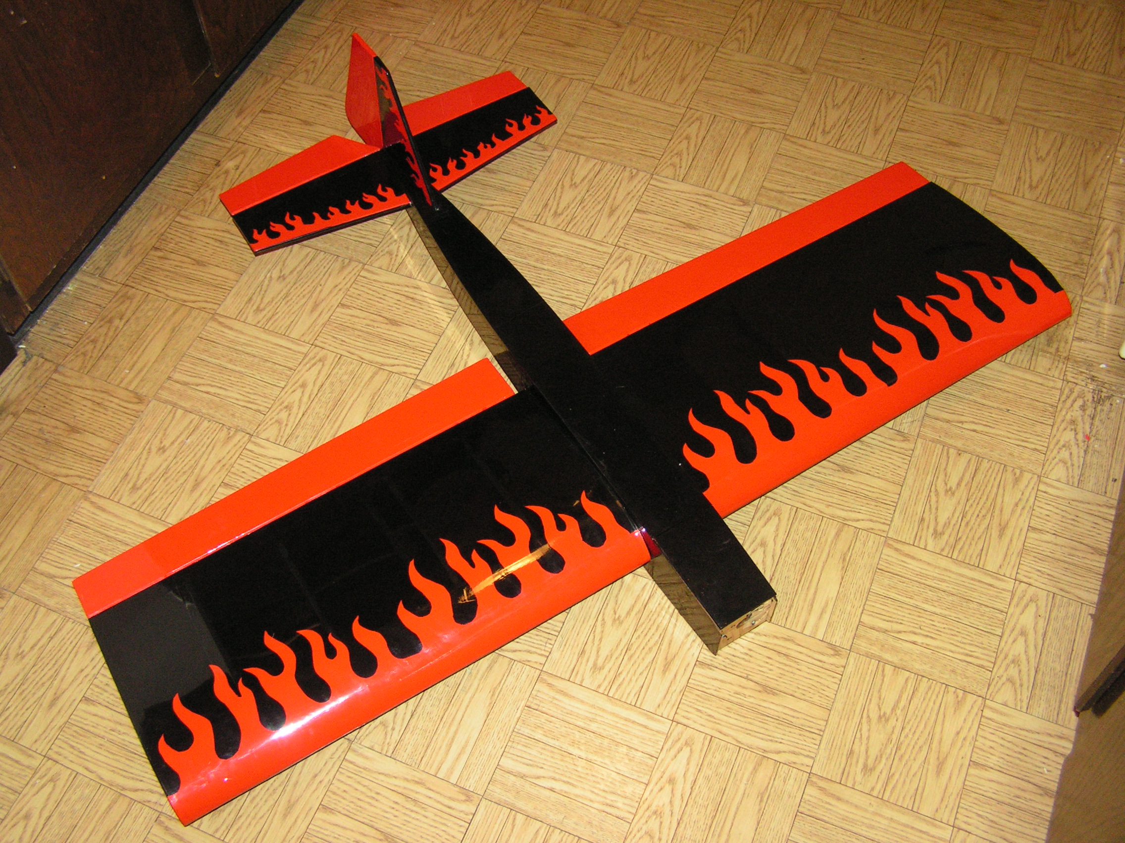

Hey Guys Im a Uproar Fan!!! I have probably 50 flights on mine 1 year old, the arf version, until the covering started coming off. anyways heres the pics of my recovering. Had to sit the plane in oil dri to dry out the oils to recover.
Old 11-21-2008 | 12:30 AM
Joined: Apr 2006
Posts: 50
From: Muskogee, OK
Default RE: uproar good enough?
sorry about the huge pic, have no idea why it uploaded so large????
