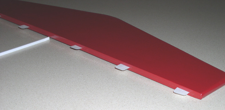

Hi All-
Finally getting around to assembling a 4 Star 60 ARF purchased back in March. Working a few mods 'glass cowling, enlarged rudder, CF pushrods, Venture 60 landing gear with pants, etc. So you can imagine my disappointment upon seeing the warped stab when I started to glue the hinges. Trailing edge of stab is bowed nearly 3/16". The Plastruct piece in pic is 3/16" stock. It's a built-up flat stab, sheeted with about 1/16" balsa. Is there any hope of straightening this out? Or do I have to build another stab? Thanks for any suggestions....Jeff

You can try bending it opposite of the warp and re-shrinking the covering but that may not help since it is sheeted. I would Contact Sig. They generally stand behind all of their products.

I had the same problem once before. I removed the covering in the recommended area that was to be glued into the rear of the fuse. I then used a wet rag and applied a liberal amount of water to the balsa and then laid a heavy book on it over night and that removed the warp. I am not saying it will help your problem, but it did mine. Or you could do what ChuckW said and contact Sig.

Thanks Chuck and Heli- I hadn't thought about calling Sig, will do that in the morning as they've always been known to be good people. If no help there, will try to re-warp it straight like Heli did before the last resort of building another stab. It's my first arf so would seem ironic to have to scratch-build a stab.

Both of the above answers are good ones. I'd inject some water ammonia mix and weight the heck out of it over night. If you have access to an injection needle you might be able to just inject, weight, and then seal the injection holes with an iron ENJOY !!! RED

If the stab were twisted, you would have to fix it. But why do you feel that a bowed stab is a problem? As I recall the 4 star has separate elevators, so you don't have to worry about a one piece elevator not fitting the warp. 3/16" of total dihedral (or anhedral) in the stab will have no effect on the way it flies. A number of full scales have dihedral in the stab and a few have anhedral. Old style pattern models often had anhedral, and a whole lot more than 3/16".
If heli's trick doesn't work, use it as is.

Personally, I would twist it just past straight and re-shrink the covering. It just might be all you need. You can usually put it between your knees and twist with one hand while heating with the other. I think it will work, but if not, you can always move on the some of the other good ideas listed above.

Thanks- I'd heard about ammonia way back in my free flight days 30yrs ago, seems people then thought it helped form balsa when soaked in a mix of ammonia/water. I am partial to a method which will be long lasting. The bow isn't centered in the middle of the stab, and I'm afraid that heating the covering alone while holding opposite bend will not be a long term fix, especially once it sets in the sun a few hours. Injecting warm water sounds like it might work, along with some heat during the "re-cure." Thanks for all the ideas!

If you use water and heat, just use a flat surface to (iron) it. It will be easy to over do it. I have, though, straitened wings using just the covering. It holds remarkably well under the pressure of shrinking, but that was more for twists.

Overdue Update- After trying all the ideas above (and more than once) I ended up calling Sig, explained the situation, and they replaced the warped stab. I can't say enough about how relieved and refreshing it was to find out that after all these years Sig remains the great company it's always been by practicing great customer service. Let's hope they get enough of our business to avoid the path to non-existance that so many other kit manufacturers have gone.
