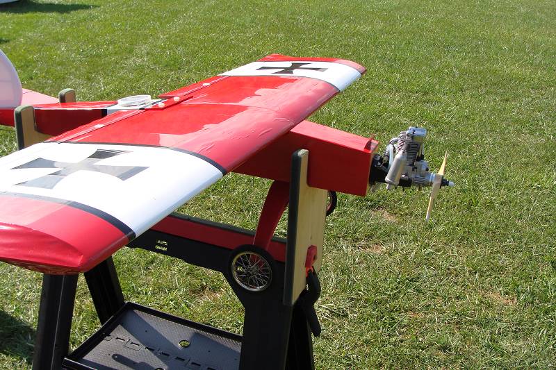

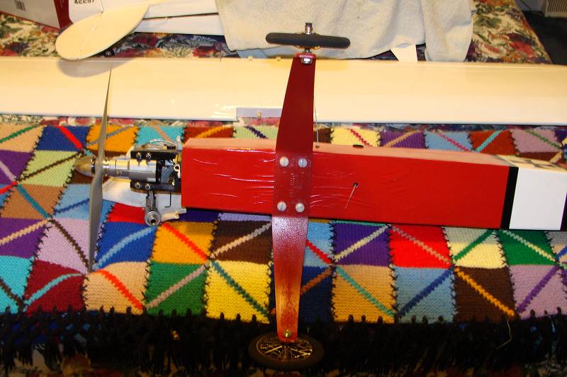

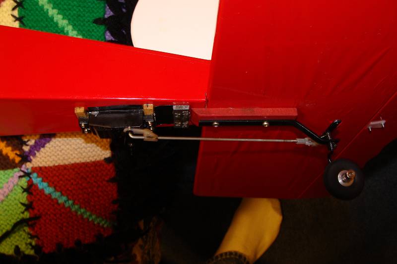

I mounted a seperate servo on the belly, in
the rear for my tail wheel. I used a Dubro
gear mount for the mains. Reinforced the
inside bottom with lite Ply. I put a piece
infront and behind the former with epoxy,
then used blind nuts and nylon bolts.
Your English is very good! I was in your Country
back in 77 or 78, when I was in the Military.
What a Beautiful place to live. Just a bit cold
though lol.
I'll try and get pics of the tail wheel later
Bob

Here is some tail wheel pics,
Bob

You do have to move the main gear forward, turning it around will not move it far enough. The drawing is how I did my Big Stik 60
I used a tail wheel assembly similar to http://www3.towerhobbies.com/cgi-bin...?&I=LXBN38&P=0 and ran a pushrod from the rudder servo to the steering arm on the tail wheel assembly. Adding a rear servo probably would have been easier. After you cut the hole in the bottom of the fuselage, glue small plywood doublers inside the fuselage to give the servo screws something to grab.

I too used the same tail wheel as Carrell, I
have my main gear farther forward. My axels
are plum with the LE of the wing. (wing level)
I agree, use the 52 size. My covering needs a going over
with an iron, it's just part of the fun.
Bob
