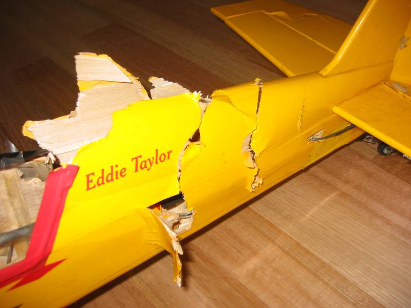

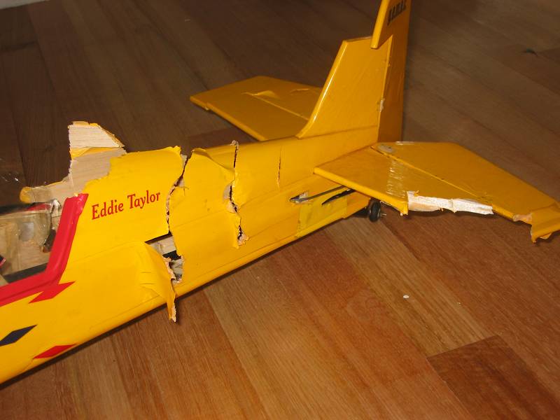

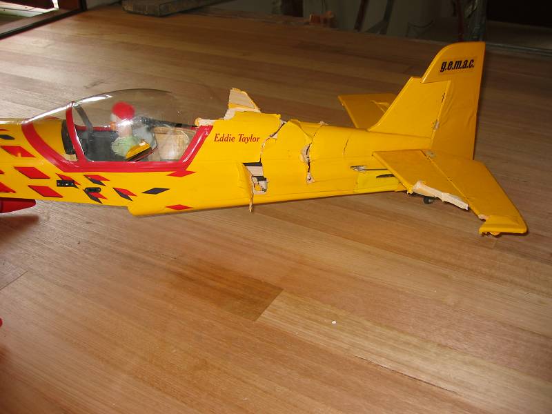

Ok two planes taxi out to strip plane1: .60 size cap 232 Radio DX7 digital servos DS821 except for throtle small HXT900 9 gram servo. Plane 2 .40 size Sukhoi Radio JR XF631 servos JR 537
I taxied P1 to the end of strip and turned ready for take off aprox 120 m away. P2 stalled at the edge of the strip so I put the radio ( DX7 for p1 ) on the gound with the aerial facing away from P1 at the end of the stip . Note the plane was at idle. I then proceeded to help the pilot to restart P2. Some time passed aprox 1min when I heard P1 throlte up to full noise, by the time I grabbed the radio we both turned and had to jump out of the on coming P1 at full speed. It collected P2 on the ground with P1's prop working its way down the fuse of P2.......... The Plane is baddly damaged see photos. P1 received damage to the leading edge of wing.
No body touched the radio ( DX7), I thought I might of grabed the throtle when picking up the radio and made things worse. We changed the prop on P1 then taxied aprox same distance away, Left it at idle sat the radio on the ground. We folded the aerial touching the ground. We waited about a minute then with out reason the plane throlted up, no thouching anything. We tried the same thing again, this time the aerial straight, so no contact with the ground. Even checked nothing was thouching the bind button on the back of the radio. After a perioid no more than a minute it did tthe same thing .... throlted up.......... Can anyone shed light on this ???????????
To me, it sounds like the spektrum receiver went into fail safe for some reason. Problem is, it sounds like the fail safe position was full throttle rather than idle. Was it bound with the throttle sick forward or was the throttle maybe reversed after binding? That happened to me on an electric when I accidentally turned the transmitter off. If that's the case though, why did it lose signal and go into fail safe? Maybe the antenna being so close to the ground is an issue?

And another suggestion. Looks like it's leading to a loss of signal and a incorrect fail safe setting.
Try this: Turn on the TX, then the plane, do NOT start the engine. Get where you can see the throttle (or throttle servo). Turn off the TX. Does the throttle go to idle, or full?
Sounds like bind failsafe puts the throttle at full, and setting the TX on the ground is causing a loss of signal, and thus a failsafe.

Ok guys fail safe is midstick and no throttle, and should I have a plane Idlleing on strip maybe not but we tried this three times and had the same result????? I love the spectrum system and still swear by it but is this a problem that has gone unoticed? Maybe ground effect? The other thing is second flight of the morning both radio and plane batt checked out fine. I even had three more flights with plane one the cap.....
Joined: Jun 2008
Posts: 349
From: Brisbane Queensland , AUSTRALIA
Tried that that the throttle once radio went off went to full open ...........so first mistry wrong fail safe , but still remains why loss of signal at no more than 120m and if was coming towards us why not regain contol once picked the radio ?

21 posts and you guys have missed the fundamental mistake of this whole ordeal ...
Never EVER put down the radio of a plane with a running engine that is not physically restrained. I don't care what kind of system it is with what failsafes. This is asking for disaster.
