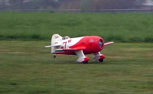

We found the KMP Gee Bee balances perfect with a 120FS (ASP/Magnum/OS) with a 1500mah rx pack under the tank and 150grams of additional lead weight as far forward as possible. These engines weigh approx. 850-900 grams, so the perfect engine for the R2 120-size would be just about 1kg - 1000 grams. A big twin or radial would impair the models excellent flying qualities!

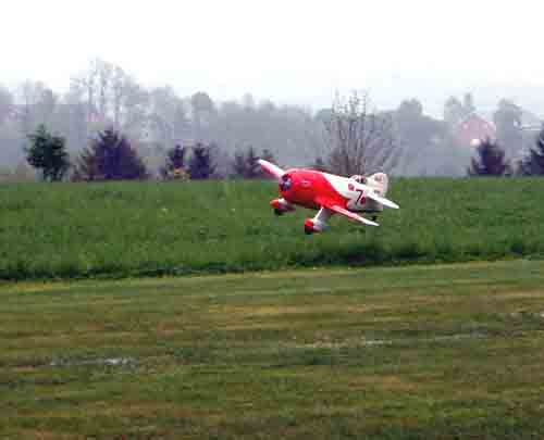

APC 16x8. Gives nice speed and normal aerobatics with ease. See other GB threads about u/c improvement - we are making a scale one with stiff rod rigging all around and sprung oleo legs.
