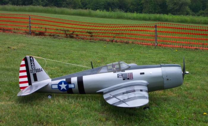

Default Here's my buddys
It's gonna maiden next weekend. Engine is a Saito 100.

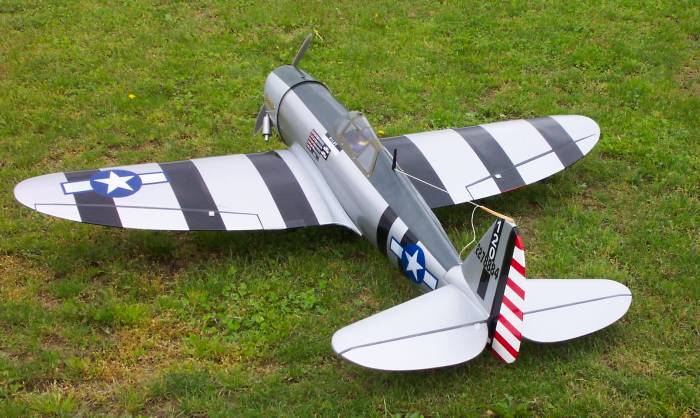

Default another pic
Here

Posts: 132
From: Providence, RI
Default I'll let ya know
how it goes. I didn't build this plane. It's a fellow flyer at our field. He's going to maiden it this weekend coming. The plane looks nice!!

Default I Flew the P47 Yesterday
I would like to thank my buddy blackdog for posting my plane.
It flew very nice. It had flying characteristics.
Prior to flying it I had to add 8 oz. of nose weight.
I'm going to add larger front wheels to it. This is because I fly on a grass field and it does tend to nose-over when taxiing.
I found when on grass if you gun it on take off nose overs are not a problem.
It's low speed flying characteristics are very good and low speed landings are not a problem.
The Saito 100 is a good fit for this plane. It flew a bit faster than scale.
If you are into war-birds, you will not be disappointed with this ARF.
Fighting Irish
