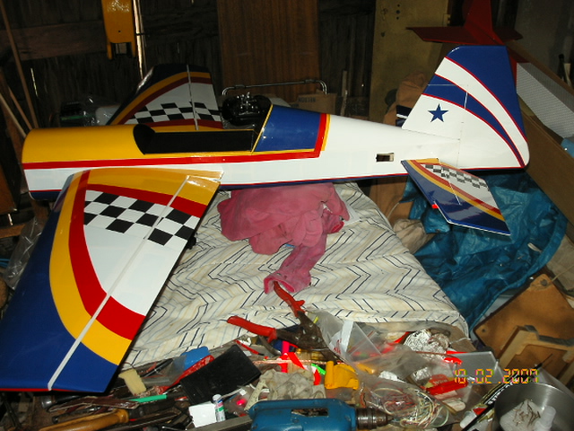

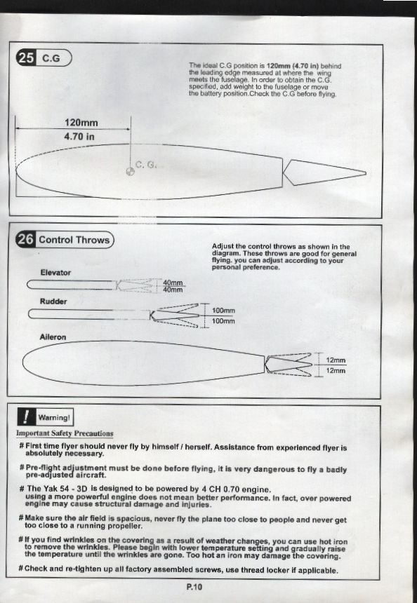

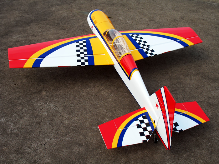

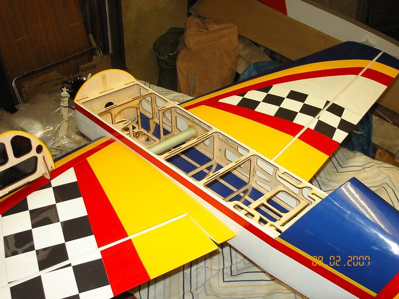

I believe I have the instructions for the plane you are referring to. Does it look like the one in the pics?
If so the balance point is 120mm or 4.70 inches behind the leading edge of the wing, measured where the wing meets the fuselage.
See Pix.
Hope this helps.

The one in your pics Alan looks to be the first version. I am pretty sure the one rcchoppernut has is the 2008 version. I have the 2008 version and it is a bit different. I would imagine the CG should be pretty close though.
