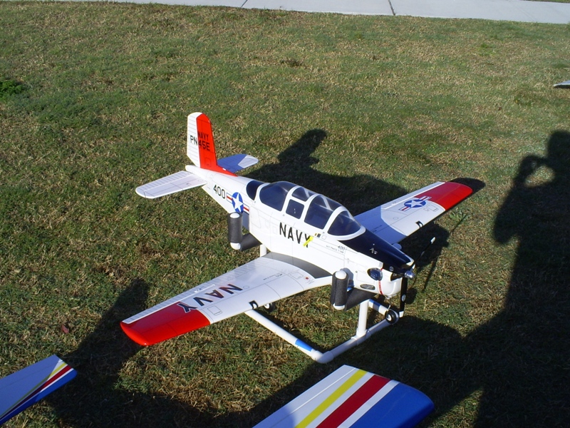

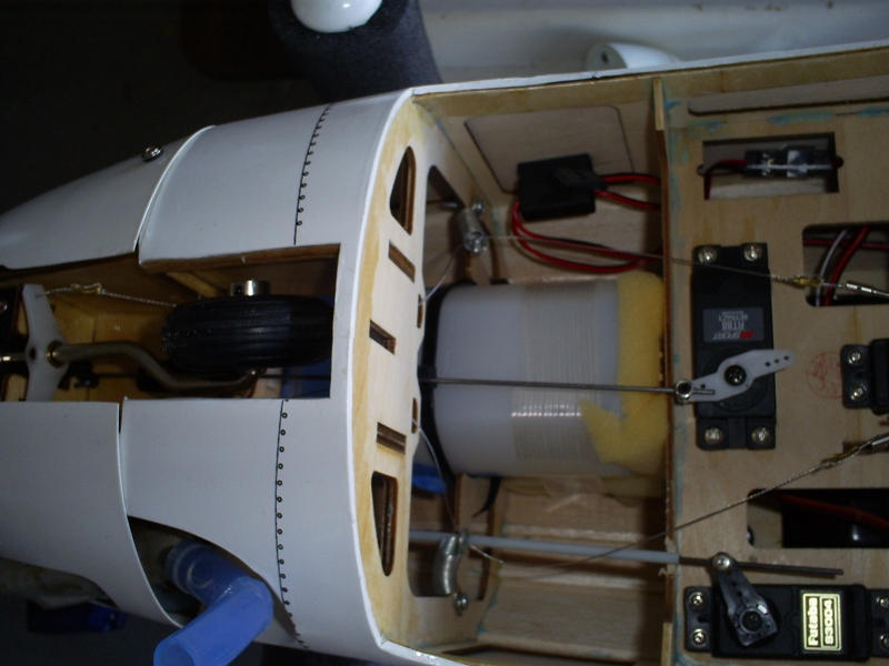

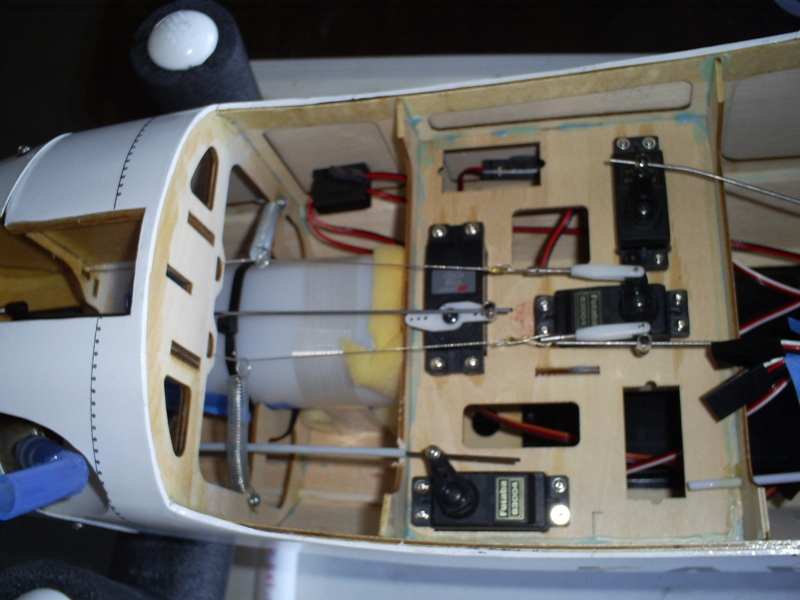

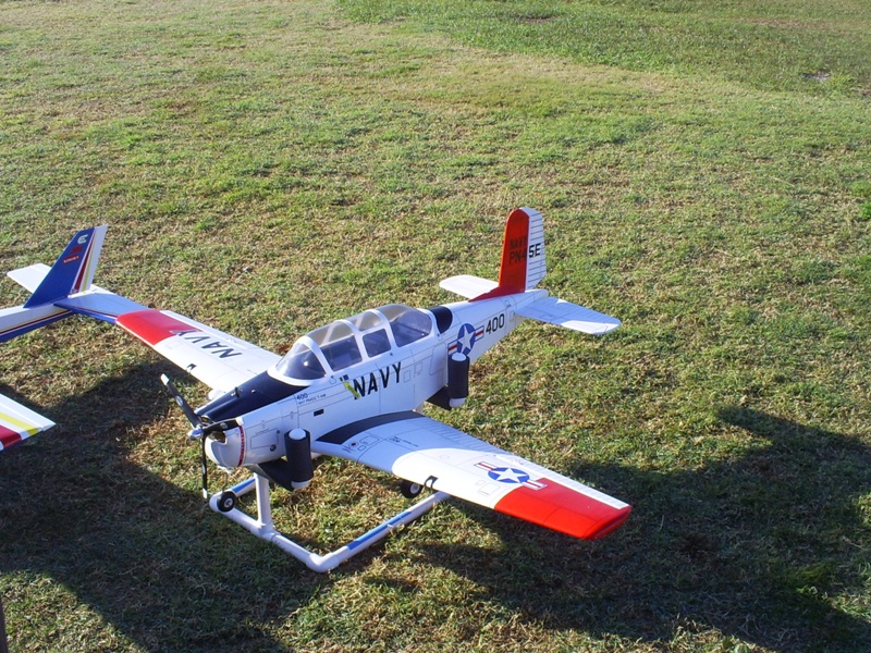

There doesn't seem to be much action in this thread, so I'll post my views of the CMPro T-34. I just completed the maiden and second flight on Sunday and first off let me just say WOW! This is my third CMP plane and the quality is on par or better than the over-priced name-brand stuff. Hangar 9 and Horizon have lost my business by doubling their prices.
Some notes I have on the build; The manual is barely helpful. If you have built a few arfs then you should have little trouble figuring it out. The nose gear cables do get in the way once retracted so I used springs to take up the slack. I powered with an OS 56FSa (great motor) it swings a 12x6 triple at 10K rpm so it has plenty of power for this plane. The retracts seem strong enough for most improved surfaces, they're relatively short and the wire is pretty thick. The flight characteristics are absolutely beautiful. Once the gear retracted, the airframe smoothed out and it was an absolute blast to fly. I tried pretty hard to get a stall out of it, but all it did was nose down, no tipping. I guess that's a property of the "T" in the t-34 design.

thanks, looks good! get any flight shots with the gear up?

Nope, sure didn't. Maybe on the next outing. Camera shots of the first few flights seem like "bad mojo" to me.

I like the spring idea for the pull-pull. I'll have to do that tonight. I tried to fly mine this weekend, but I had a locked up retract servo on the mains[:@], so didn't do anything on Sat. Of course, the gear was in the up position- I didn't feel the need to mess with them to lock them down - had a couple of other planes to fly before the high winds came in! Sunday, the winds were just too high for a maiden flight.[&o] I did finally get a pilot in mine, so it looks a lot better. Maybe this weekend I'll finally get it airborne[&:].

Ouch, I knew those cables would snag on something. I used the factory 85mm cg (it looked to be close). With the rx battery on top of the tank, my CG was at 85mm with an empty tank. The springs came from a Harbor Freight storehouse set #93323.

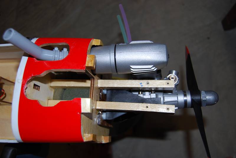

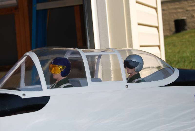

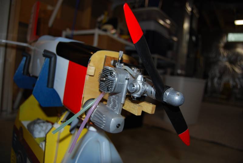

My O.S .46 AX the newest one was oustanding for my mentor plenty of power and nice aerobatics.
added some pics on the engine placement and add the pilot pictures to make bassfinder jealous...

Looking good Claw. I'll have to do some work on my cockpit area.

thanks guys,did anyone have to extend the motor mounts out from the firewall or did you mount the engine at the very end of the mount? i measured how fari would have to mount the engineon the mountand there is very little material between the bolt and the end of the mount. i was thinking of mounting some blocks to the firewll then the mounts, thoughts? i was gonna use a os46 but i also mounted a saito 56 with the same results. mark

I used the factory supplied mounts. I dry fitted the cowl and used a ruler to measure from the firewall to the end of the cowling to establish where I needed to mount the engine to ensure proper clearance for the rear of the prop spinner. Then I tested fitted the engine to get the right measurement. Once that was established correctly, I added about 1/4 inch for good measure and marked my mounting holes on the motor mount. Drilled my holes and mounted the engine. Measure three times to make sure everything is right before you drill the first hole. Plenty of room left on the mounting beams even with a Saito .65.

bassfisher i did the same dry fit but i seem to be coming up short, i can mount at the very very end of the mount and make it happen but it seems a little close to the end of the mount for me. i might just add some ply to extend and back the engine up some if need be.

mistermnkim - you might want to get get a new motor mount with longer beams. Dave Brown makes a good one piece with long beams.
