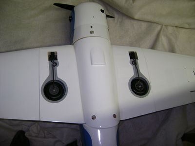

Default Hanger 9 F6F Hellcat 60

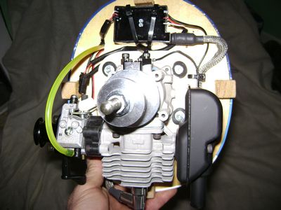

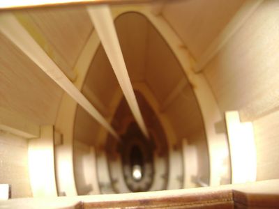

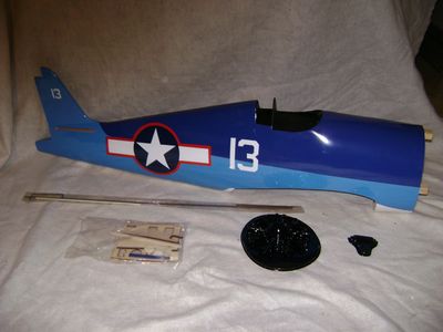

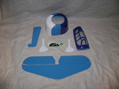

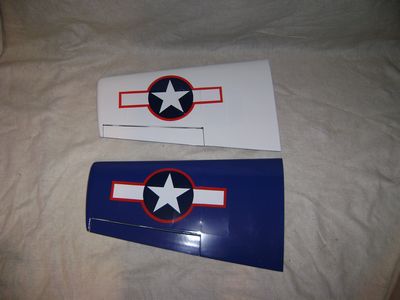

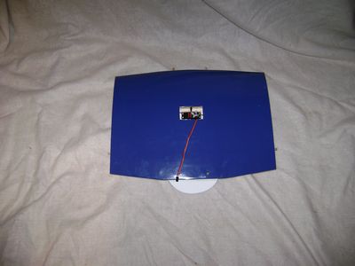

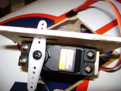

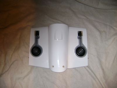

Hi, just wanted to share some photos of the Hanger 9 F6F Hellcat 60 ARF that I'm building. On this air plane I'm installing a Zenoah G20 EI engine, I will also be installing a Fiber optic kill switch system. The Rx will have a independent battery from the engine. Hanger 9 done a great job with this plane. Would recommend highly to all. Please fell free to comment on any thing you see that will not work, new to RC Airplanes but like to build models.
Thanks for your help.

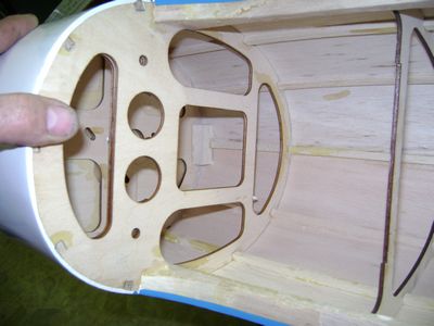

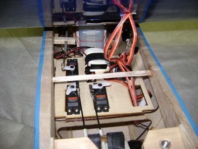

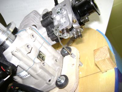

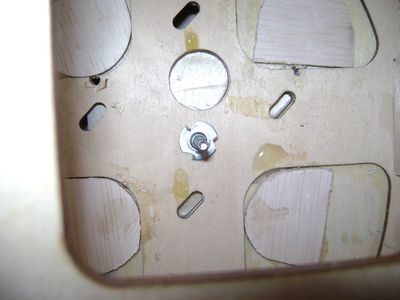

Firewall change. Used 30 min Epoxy, fiberglass and blocking to help strengthen. Had a RCU member leave me a post about his plane crash. Thanks a lot to all the members on RCU for their help and support.

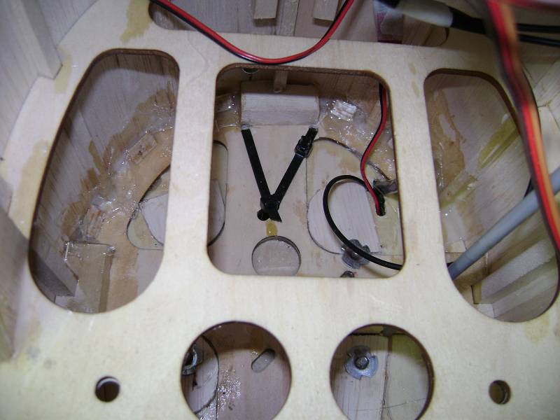

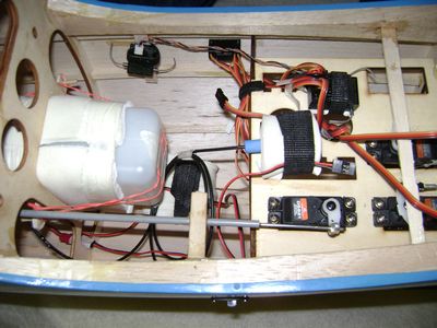

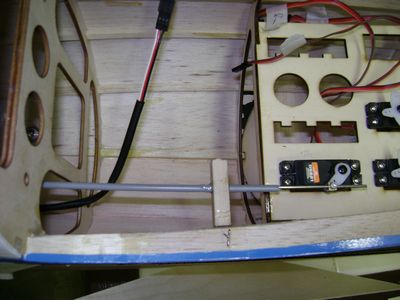

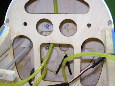

Just wanted to share more photo. The throttle was very hard could not find pictures on how it was set up on other Hellcats with the G20 engine.
Added Throttle rod change photo.
Thanks for looking.

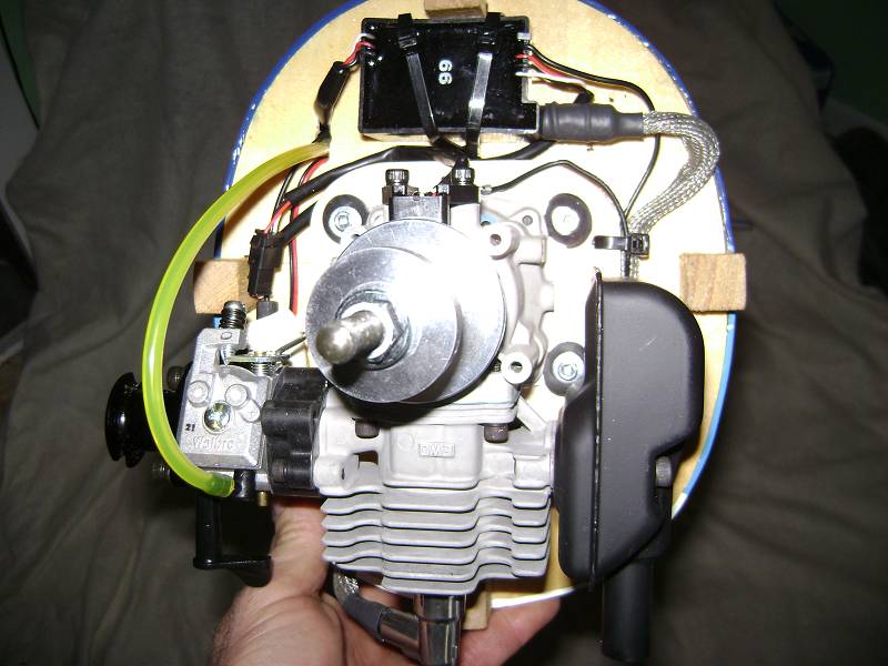

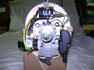

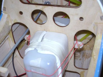

I can't tell for sure, but if your ignition module is wraped up tight in foam etc. that's a big NO,NO!
Those Zenoah modules get hot fast and use one side or the other as a heat sink that should be to free air.
Wraping one up is a sure way off burning it out![:@]
Old 02-01-2009 | 09:16 AM
flystright's Avatar
My Feedback: (13)
Joined: Jan 2009
Posts: 307
Received 2 Likes on 1 Post
From: Rush, KY
Default RE: Hanger 9 F6F Hellcat 60
Thanks, wil change to open air. Witch side go's out.

Instructions on how to mount the ignition module can be found here:
http://www.horizonhobby.com/ProdInfo...%20_Manual.pdf
On page 5
Hope this helps!

Thanks, this was all I needed at the begining of the instulation. Should have asked for a link to the manual. DA.

Last weekend, my Hangar 9 F6F Hellcat crashed when the firewall separated from the fuselage. Once the wreckage was recovered, to my surprise, the firewall was hot glued to the fuselage instead of being epoxy. Therefore, you may want to reinforce the firewall to the fuselage. I must agree, that the Zenoah G20ie is the right engine for this airplane. The Hangar 9 F6F Hellcat is a smooth flying airplane. I really enjoyed flying it.

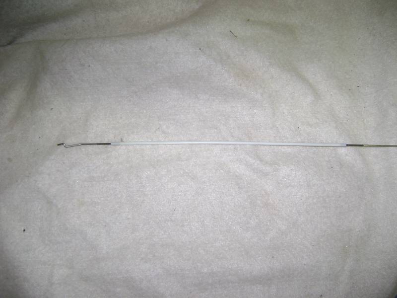

Hi all, I have a question. Here is a photo of the Throttle rod I'm planing to use. Just wanted to know if this type of rod will work, it's was all I could find at my LHS.
Great Planes Flexible Accu-Glide Nylon Pushrod (914mm)

No!!!! The throttle linkage you show would not be a good idea as you have metal to metal contact (metal rod, metal arm on carb) which would eat you alive with glitching. I always use Sulivan Nyrod with the included 2-56 1" long piece of threaded rod with a plastic ball link connector screwed on and of course, the matching ball on the throttle arm of the carb. This way, it is only plastic on metal contact which is safe. I am sure you have read up on the many other safeguards of a gasser haven't you?????
Have you read about 2.4 Ghz? It is imune to the traditional metal to metal RF interferance. Look at the pictures in post 20 and you will see his 2.4 Ghz receiver.
