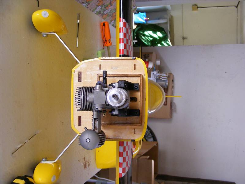

I'm building an Edge 540 .46
After I have mounted the engine too the brackets which is attached too the firewall...The engine is skew, it turns down too the right at an angle - I know they talk about the thrust etc. Is this "skewness" correct or should the engine be straight towards down the middle of the plane. I just don't want too maiden the plane and have an incorrect mounted engine.

Okay here are some pictures so that you know what I'm talking about in more detail.
I checked the line up from the tail - it seems too be in a line - perhaps half a mm out.

Is that engine mount stock ? did you build
or assemble the mount ? The reason I ask is,
that first pic looks like alot of right thrust.
Bob

I agree with that it looks like a lot of right thrust, that's why I'm a bit in the dark. I assembled the mount - mounted it onto the already installed firewall then mounted the engine on it. The holes drilled on the two mounts are right across from each other - so I know I didn't mount the engine wrongly on the mounts.

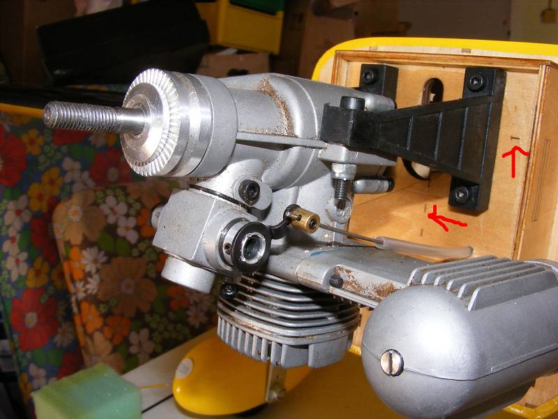

Default RE: Engine Mounting Question
ORIGINAL: Zippi
Korps,
Most of the time there are two vertical lines on the firewall. One is the center line and the other is the off set line for the thrust. Your motor mount should be set up on the off set line and as long as the end of the crank is on the center line your ok.
There is one horizontal line about a fifth or so from the top of the firewall then there is one vertical line going down. In the picture both dashed lines can be seen on the firewall.

Old 02-01-2009 | 10:01 AM
Joined: Oct 2005
Posts: 1,993
From: Deland, FL
Pic #3 in in your first post with pics. It looks
to be about right. I would do some taxing test
before trying to fly.
Bob

In your original photo the engine mount is the problem...
Look at the photo and pay attention to the right arm of the mount... as seen by a pilot...
It is angled OUT at the engine. This means that the mount was set with the arms too close together at the base.
When you mounted the engine you effectively added more right thrust than that provided by the firewall.
You need to always make sure that the mount arms are parallel to each other and perpendicular to the firewall, before you drill the engine mount holes.
