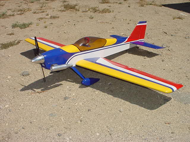

I'm working on my Aresti and I have stumbled across a few things that I wonder if anyone else had a problem with.
1) The axles--too short to center the wheel in the wheel pants
2) Fitting the wheel pants--I drilled the first hole 5/8" up from the bottom. Now my wheel rubs agaisnt the wheel pant
3) The wing bolt plate--the plate is flat,; the wing is not. I sanded the exposed wood, sanding more out of the middle and tapered up to the outboard sides.
So far, these are the problems I have ran into. Nothing major, and 2 of the three are easy fixes for the manufactor. Just put in longer axles and change the instructions to drill the hole 1/2" up form the bottom. I still really like the airplane and look forward to finishing it.
-Bob George

BGI,
The axles were about 1/8" inch too short. Normally I wouldn't worry about the wheels being that small amount off center, but it was an issue this time because I needed the wheel centered due to the rubbing problem. The rubbing problem would have been easily solved had I just opted to buy some 2.25" wheels, but the 2.5" wheels that came with it looked good and they were fairly light.
I did get rid of the heavy engine mount that came with the airplane. I plugged the holes and installed a Great Planes 40-70 size mount. I needed to eliminate that extra wieght because I am using a .61FX I had laying around from Great Planes Mustang that is no longer with us...
I am really looking forward to flying her. All I have left is to install the radio, fuel system, and pilot. I am waiting on some new servo grommets from Airtronics and I haven't been able to find a Scooby small enough to fit the cockpit yet, so I guess I will install the fuel system next.

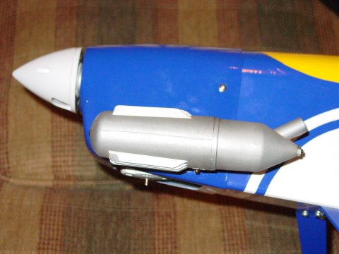

Bruiser.. from looking at the picture of the Aresti I might suggest loosening the bolt of the muffler and turning the exhaust so that it points down and away from the fuselage.. will helpreduce the time you spend cleaning after flying

On the landing gear: I ended up using a spacer nut and the wheel collars to center the wheel in the wheel pants. I had to cut off some of the length of the axle to fit it in the wheel pants. And I had to cut a slot, not just a hole, to slide the wheel into place in the wheel pants. There was no other way to get it all in there. Then I used an aluminum washer on the inside of the wheel pants to cover the slot.
By the way, Testor enamel paint--red and blue--match the color of this plane well, and it is fuel proof. I used these colors to touch up some hardware, like blue for the nuts for the wheel axles, and blue for the elevator control horn plate on the tops of the elevator, and red for the same thing on the top of the ailerons. It makes the plane look a lot sharper--look at the photos I posted. I got the paints from Michael's Crafts.
As far as the wing bolt plate goes, the gap was small for such a slight angle on the bottom of the wing. After I exposed the wood, I just used epoxy to fill in the gap. It didn't take much glue, and I figure it made the structure stronger.

Have a couple of dozen flites on my Aresti and I guess it's an average plane. I like it and it's an easy flier.Not a speed plane by any means but gets the job done.It moves pretty good with a Irvine 53 and 10X7 prop.It was almost impossible to control at first till I cut the throws way down.Like "way" down. I set the ailerons down a bunch and it flies much better. It's nice to look at and gets a lot of complements.The only thing about mine is that I bought it from a guy and had three or four flites on it.The canopy is tinted yellow which is fine but when you look in the cockpit theres nothing there.I just can't see haveing a clear or tinted canopy and no pilot...If you can see inside,let's put a pilot in there. A guy at the club brought out his brand new U/Can/Do yesterday. A nice looking plane except a clear canopy and nothing inside.I guess that's just a peve of mine...If I don't fix up a cockpit to look scale,I paint the canopy where you can't see inside.
But you'd probably like the Aresti.Nice looker and nice flyer..Just watch those throws.
