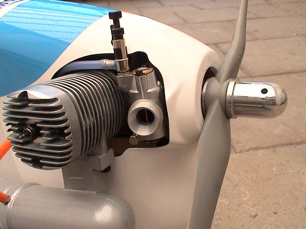

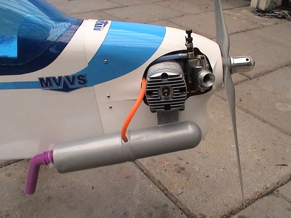

Default RE: Mounting OS 55 on U CAN DO 46
Hi!
Mounted my MVVS 15cc (91) sideways on my You-Can-Do.60.
I use a 12 oz tank (original is way way too big) and a 15x6 APC prop for best performance.
