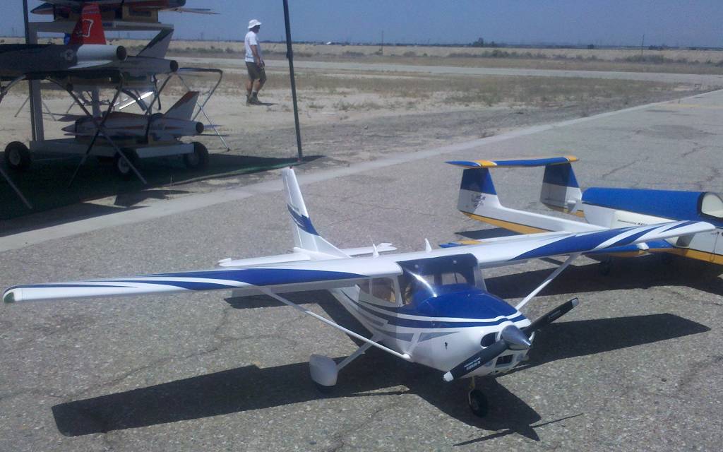

I installed a hardwood bearing on rudder control arm and short push rods to stop the flutter.Also I installed baffling on my saito fg 20 to stop the overheating.You do not want to
open up the bottom of the cowl because it will decrease the cooling.
