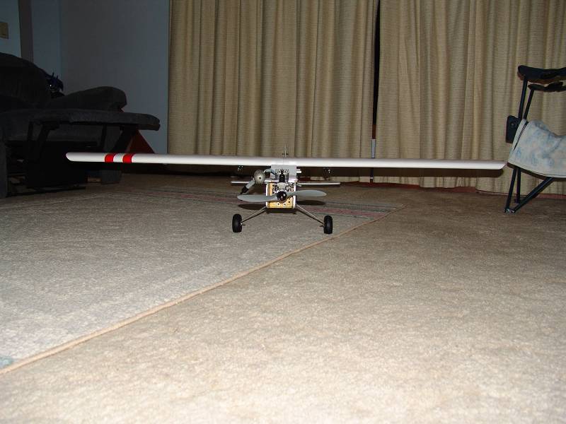

Since dihedral is part of the standard 'trainer' design, you'll have to modify any ARF trainer to remove it. The Global Right Flyer 60H, if still available, has very little dihedral so it would be easy to flatten. The first picture is a Right Flyer assembled per instructions.

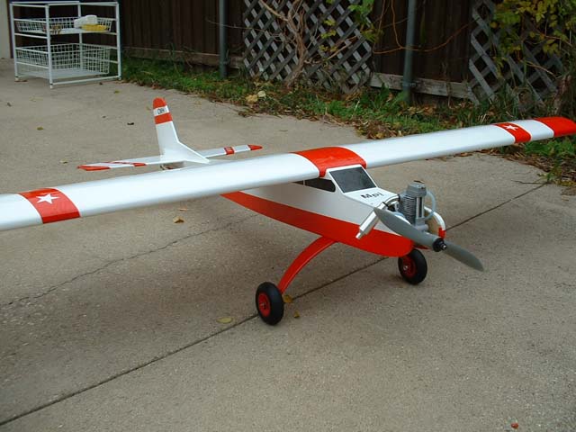

If you're in a position to build a kit, the Great Planes PT-60 is easy to build with a flat wing, second picture.

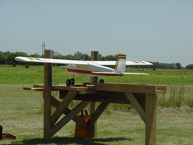

I wanted a sporty trainer option and turned my Superstar? 40 into a wild trainer for those who wanted to step up without getting something elso.
I made the plane a taildragger, removed dihedral, and added dual aileron servos.
