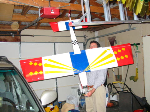

Wanted to try something a little larger than my .40's ... Here's a World Models SuperStunts 60. Powered by TT .61 PRO ... setup for seven channel operation ... crow and everything. Will go up this weekend.
Wish me luck!

I had the 40 size a couple of years ago, it was a real bad flyer but I've heard some good things about the 60 size.

You will love this plane. Will fly in all weathers, it will even fly backwards on a breasy day with crow on, at least it seems lke it does.

I have both the 40 and 60, both awesome planes and perenial favorites in my hangar. IMHO, they should have been labeled 60 and 120 instead, as they are roughly the same size as the H9 Ultra Stik 60 and 120, but much better constructed.
If you like big huge floaters doing the CROW thang at 1mph over the runway, you'll definitely like this plane.

Well ... Due to some unforeseen delays, I didn't actually fly it until last weekend. I got about eight flights in.
The TT pro61 is a nice engine. I usually fly OS, but this engine seemed just as good, and actually a little easier to tune ... the low end idle was set correct out of the box.
The plane flies SUPER easy. It's very slow, and even at full throttle, it's pokey. Slow roll rate ... excellent rudder response, I could fly around the field with only rudder and elevator.
I set the ailerons up so that flaps and ailerons would move together when I flipped a switch (guys ... what's this called?) The roll rate improved somewhat, but it's still pretty slow.
Landing couldn't be easier ... with or without flaps ... super slow approaches and it just settles down ... almost don't need to flare. On one flight I deadsticked and it was just as stress free.
Overall? It's easy and relaxing to fly ... Not the most challening plane to fly in the world, but sure alot of fun. I think it will be a regular for me.

The Superstunts 60 is a blast to fly. I was teaching myself to prop hang with it. It was completely destroyed when I flew it inverted thru a tree. Just wish I had video of the crash. It was something to see. I miss that plane. I have two videos of it flying, one is of it prop hanging on my website on the "Movies" page.

I don't think there is a specific term for this, but it's usually refered to as "full span ailerons".
I have mine set up so that on a 3-position switch, down is CROW or airbrake, middle position is normal flying, and up is full span aileron and elevator->flaps mix for fast rolls and tight loops. I swapped in 3" wide quad flaps so the roll rate is quite a bit faster with full span ailerons.
