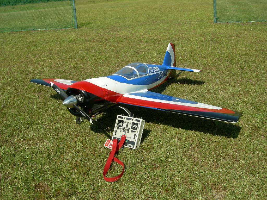

Thought maybe one of you folks that bought one might have updates.
I now have many flights on mine and finally learned to make 3 point landings and sometimes slow enough to be tail wheel first.
Flying vertical I have to hold down elev for straight up flight. The nose wants to pull up and over.
Landing I come in fast, hot low power and only add flare over the runway. Timing is everything as the large round cowl adds lots of drag and it slows fast. Keep idle just a couple clicks up from full idle.
I increased the wheel size on mine 1/2 " more than factory wheels for a little more shock / less bounce on the grass.
Flat spins are possible. Haven't been able to do inverted.
Flat spin is about 60 degrees up power off full up and left aileron until it begins to spin then in the spin hold full up but slowly move aileron to full right. Add a touch of power if the flat spin is entered.
Recovery from the flat spin. I give a touch of right rudder and center elev / ail. Power is back and I add a bit of power in the pull up.
WARNING RECOVER FROM THE FLAT SPIN HIGH.
Almost lost it this week due to color on the wing. Pattern is the same top and bottom. Plane was slow and under gray cloud. It snapped in a turn and I could not tell after the snap which side I was seeing. Fortunately the wheels
are on the bottom and I recovered.

Snap is too slow AND too much elevator. Keep the speed UP until you are comfortable. Too little elevator is better than too much.
I am flying at 1/2 recommended throws listed in the manual. You are correct.
To put bolts inside the fuse you will have to cut a piece of plywood and put it inside the inner most wing rib in a location where you will be able to drill through the fuselage. (I reco 1/4 " ply so you can thread it with a tap.). Then you can put a nylon bolt from inside the fuse into the wing. I havent done this yet due to being out of town.
CAUTION KEEP up the speed on landing. Fly it in on about 1/4 throttle until over the runway then cut the power.
I use expo also on the elevator. More to come later tired from driving 500 miles today.

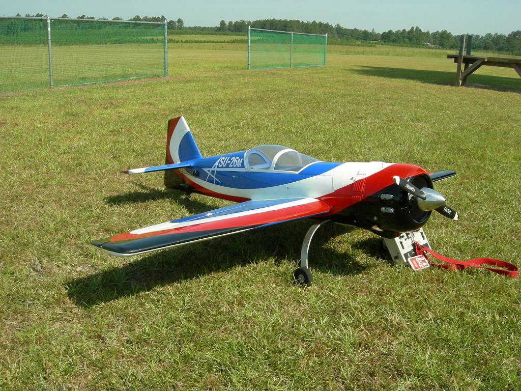

I maidened mine last weekend. Once she was trimmer out she flew great. Had WAY to much on the ailerons. At full deflect the sucker barrel rolled and was almost a blur. She took it though!! All was well until the engine died...I have an O.S. 1.20 2 Stroke in it. Plenty of power, when it was running
After the engine died, it dropped like a brick!! I was able to flatten it out at the last minute....it landed about 10 feet from a swamp and 3 feet from a tree.....only damage was the gear bent a little cracking the wood block where the gear bolts up...no biggie. easy fix. Another thing during crash was the whole rear elevator stabilizer came unglued. Like Jim said, you gotta get in there with some glue. I already ordered some syringes to get it in there.....the way the instructions have you do it obviously there was not near enough in there. Live and learn I guess.
In response to the above post with the 22 inch prop....sorry to say I don't see that working. I just measured my clearance for you. I have a 15" prop on it. With the tail level there was roughly about 3 1/2 inches from the tip of the prop to the table it was sitting on. With the 22" as soon as the tail came up slightly, it would become one with the earth
After the engine died, it dropped like a brick!! I was able to flatten it out at the last minute....it landed about 10 feet from a swamp and 3 feet from a tree.....only damage was the gear bent a little cracking the wood block where the gear bolts up...no biggie. easy fix. Another thing during crash was the whole rear elevator stabilizer came unglued. Like Jim said, you gotta get in there with some glue. I already ordered some syringes to get it in there.....the way the instructions have you do it obviously there was not near enough in there. Live and learn I guess. In response to the above post with the 22 inch prop....sorry to say I don't see that working. I just measured my clearance for you. I have a 15" prop on it. With the tail level there was roughly about 3 1/2 inches from the tip of the prop to the table it was sitting on. With the 22" as soon as the tail came up slightly, it would become one with the earth

You mentioned having 3 1/2 inches of clearance with a 15".
I'd love to go with a 20"... but it would leave me with just 1" between blade tip and ground.
Guess I'll have to opt for a 18x10.
This would give me a couple of inches clearance.
Do you think a 18" is feasible?
Would it be possible to "straighten out" the gear in order to increase the nose height?
Thanks again.

I tried a 22" prop on my saito 1.8 and it was too much prop, lugged the engine and way down on torque. The plane flew like a truck vs a hot rod.
