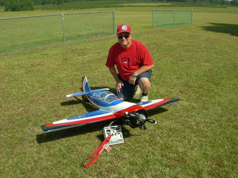

It has flown. The first flight was exciting. NOTE : the rates shown in the manual. I used the manual LOW rate as MY HIGH RATE. I used 1/2 of the Low rate setting for flight. The plane balances exactly on the 4" mark and inverted takes a small amount of pressure to maintain level flight. I may take out 3 oz of weight later.
The elevator and ailerons were way too sensitive at the manual settings. The manual low rate made flying a bit easier.
Flying on the first flight at the low rate settings from the manual I was able to get into (lost count) many tip stalls due to sensitive elevator.
The first landing was bumpy. We had 15Knot cross winds and the landing had a strong gust of wind with the plane balloning up. I was a bit nervous to try and hold it at the low speed with elevator afraid of tip stall but landing was a engine running taxi back landing.
The second flight on lower control settings were more controllable but the winds still did not slack off. The landing was a long low approach with rollout on the runway and about 6' into the grass.
I planned a 3rd flight but the winds continued to pick up and since I was working on control settings I didn't want to push my luck.
The saito 1.8 with 16x8 prop turns 9700 rpm richened to 9400.
Power is great with 1/2 throttle take off. I used 3/4 throttle for normal flying but given the sensitive controls I didn't do much in areobatics due to the elevator tip stall at the high rates.
I am sure this will settle out with more flying.
Summary nice bird flies close to my Extra 300 but high wing loading. Very controllable if you watch the control throws.
Critique. some of the covering has bubbled after flying and needs ironing. The canopy has a 1/8" crack at the front edge by the cowl. Don't have a clue how this formed there is no pressure.
The XPS 2.4 preformed exceptional as normal with a new receiver.
More to come with more flying time. Yes I still would buy it again at $150.

Update. Flew 4 flights today. Light winds and temps.
Few things
1) When landing carry power like a bipe and don't pull all the power off until about 3' over the runway. If you do it will drop like a stone. I set full throttle trim for takeoff and leave it that way to land. I also add 2 clicks on the throttle stick for flying until power off for touchdown. The plane will taxi at full throttle trim but not fly.
2) Vertical flight the nose tucks down up elevator is needed to maintain vertical
3) In slow flight mine will drop the left wing tip very quickly. Not a soft stall
4) The wing screws came loose in flight. I almost lost a wing panel with a screw comming out. If you overtighten it will break the wing panel. I will modify for inside screws. THIS IS A WARNING TO YOU !
5) The 1/8" lite ply screws holding the rudder in place stripped out. The lite ply is too thin. Reinforce it with spruce below before inserting the rudder servo.
6) The 3 1/2 " wheels I added made for better rough field landings.
Otherwise the plane flies very smooth and precise. Flat spins are nice but WARNING it takes a lot of airspace to recover. I actually got into an accelerated stall while diving out of a spin.
More to come but it will be 2 weeks before flying again.
