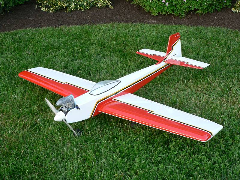

Old 07-02-2009 | 06:50 AM
smkrcflyer's Avatar
Joined: Sep 2006
Posts: 1,022
From: Hamburg, PA
Default RE: Tower Kaos ARF Flying Issue
Here is a picture of the kaos with the Evo 46.
