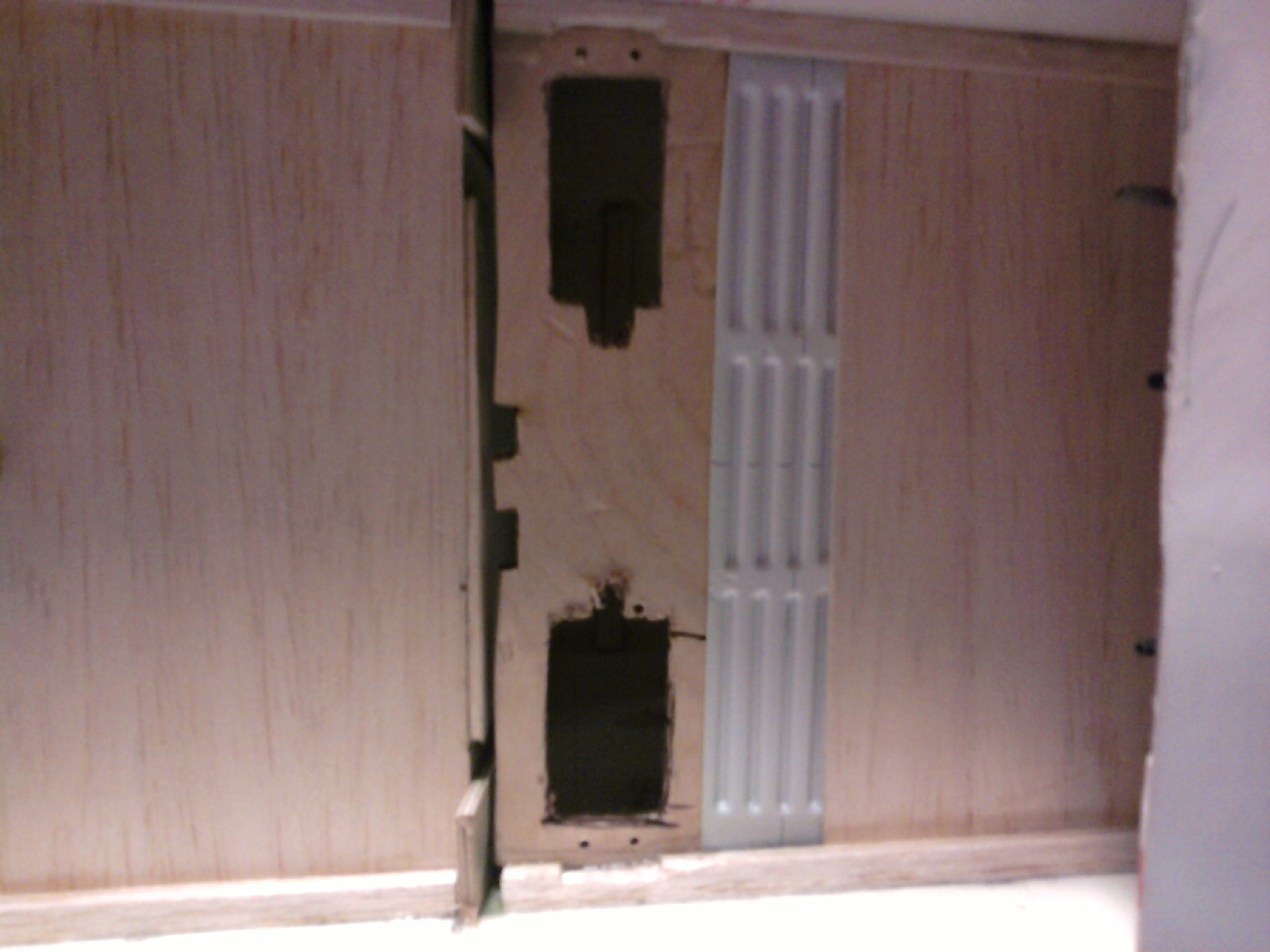

Rudder and elevator servo installation:
I did find a place for these between the cockpit floors. There is enough room for both of them when they're placed sideways and the servo mount glues to the floor supports. So, looking at this, I cut out a rough rectangle in 1/4" aircraft ply. A little overkill, but it's all I have. After that, I cut out the holes for the servos, they don't look great, but they work. after I checked to see that everything fit, I glued the block into it's spot. It still needs some fillets on the other side, but it will work.
Also, here is a pic of the cut out compartment. Due to a space issue, I need to move the servo to the back of the compartment and the tank to the front. Easy enough.
The next thing I'll be working on is the installation of the engine. I've never worked with a gas engine before, but I'm guessing that it has to sit on a plywood box, right? The instructions for the engine don't say much about installation. Both sides of the mounting standoffs accept a screw, so does this mean I have to put all-thread in the firewall and screw them to that? Do I have to keep the reciever away from the electronic ignition? Also, has anybody ever worked with an RCGF 26cc engine? Is it any good?
