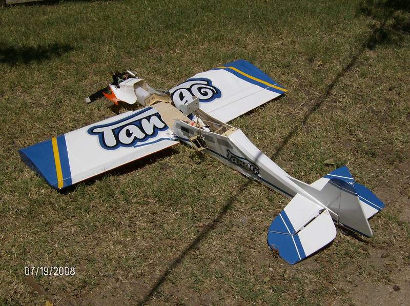

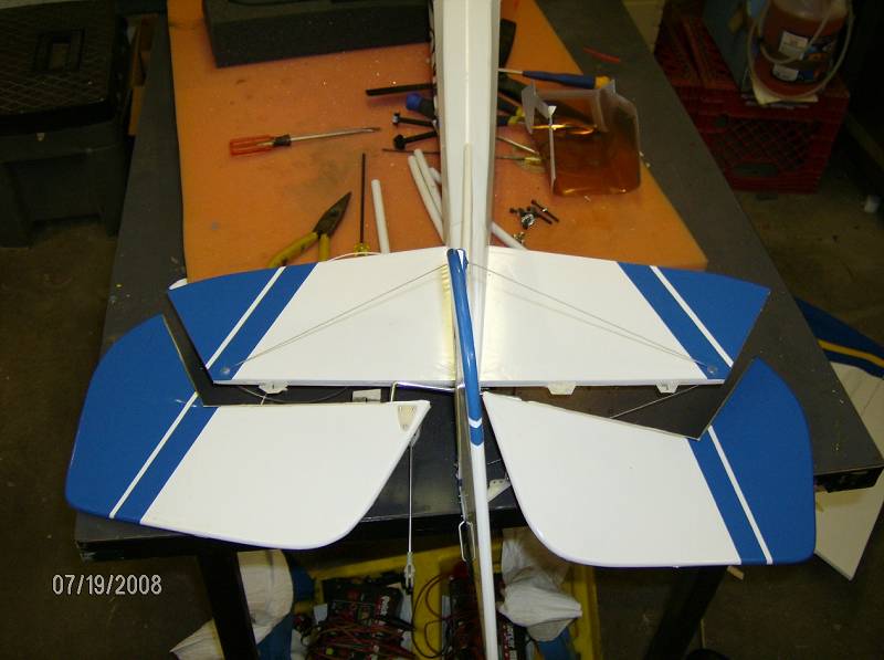

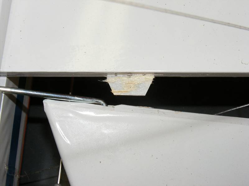

hello.............on the second flight of a hanger 9 tango.......all 4 of the elevator hinges pulled completely out..! the plane landed in a tall tree......completely destroyed the plane.....buyer beware.......pin the hinges!.......pault

Checked the manual on line at Horizon Hobby, it says to pull test the ailerons, does not mention testing the elevator or rudder in the manual. Sounds like this might be a warranty issue with Horizon. I would call them if I were you.

i have already contacted the hobby shop owner....he said pull the radio and motor ....drop it by the shop and he would take care of it........3 cheers for the local hobby shop...pault
