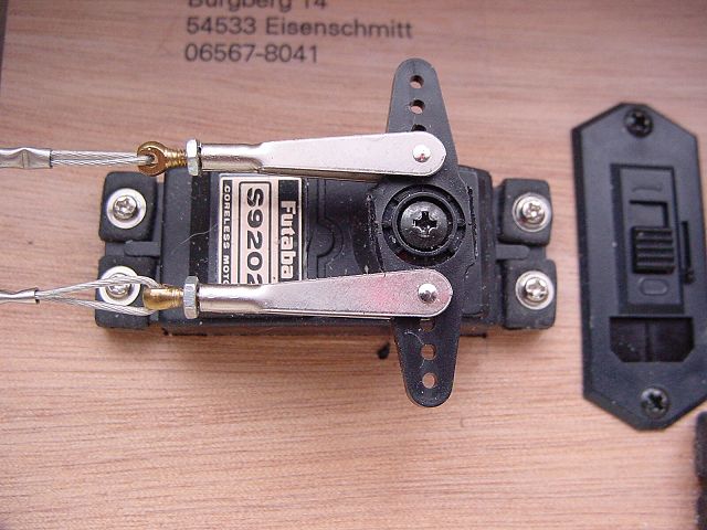

This works for me in some fairly large sailplanes and mid sized power. Do not tension the cables too tight (common mistake).
Gary

Thanks, George.
Looks like the Nelson will be more appropriate for the installation I have in mind.
Ok, you guys have sold me on the Kevlar. The "kit" that Don's Hobbies sells looks to have crimped connectors; but there appears to be some parts missing in the small photo.
What kind of connectors does this "kit" come with? 4-40 threaded is what I need, since I will use a metal clevis on one end and a ball link on the other. I already have that stuff; I just need the kevlar thread and connectors.
