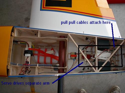

Was setting up the pull-pull rudder system in my H9 1/4 Cap last night. Using stock set-up...I had read on these boards that the stock wires were weak...so I soldered them up, and put them in a vice...hooked a fish scale up to each wire and tested 'em both to 25-30 pounds indicated on the scale. Seems OK to me.
Installed a new Hitec 645MG servo...This is a hi torque, metal geared servo. Yeehaaa. Fed the wires through the fuse, dinked around with everything until the wires were fairly tight when the horn is attached to the servo. Got the radio out, centered everything up, and wow! What a lot of noise! The servo groans every time it is released. I decreased the tension on the wires a little bit, and that helped some...but there was still a decent amount of noise as the servo tried to center itself. (when the rudder control was released) I've never set up a system like this before...in my other planes, I would have serious issues with a servo groaning like this.
By the way...in my opinion, I really can't loosen the wires much more...any ideas?

Your servo shouldn't scream at you. Make sure you don't have any binding. Check that the surface moves freely (no hinge binding), that the cables don't touch anything inside the fuselage, that they aren't suffering from "stiction" if you have them inside cable guides, and that you don't have any binding where they pivot on the control and servo horns.
Also make sure there's no force exerted on the surface from the tailwheel on the ground or tailwheel springs.
If your servo is a 5645 that would be a normal digital servo squeal. If it not then I think you have a problem. Does it make that noise when it's not hooked up to the pull-pull wires? If yes, its a bad servo, If not then it's one of two things; 1. Excessive friction or 2. The geometry of your pull -pull linkage isn't right.
Oh yea, make sure your tail wheel is not sitting on the ground...

Hey guys...thanks for the great suggestions and ideas. The airplane is laying on it's back on the bench, and there is no part of the tail that touches the ground. (or anything else for that matter)
When I get home I'll have to make sure that the wires aren't hitting anything inside the fuse. I'm pretty sure they aren't, but hey...
Also...The servo sounds fine everywhere through it's range except when it is released...It's like it has a problem centering.
When I release the rudder/throttle stick, the servo will hum loudly for a couple seconds and then eventually center and shut off.
My NEW thoughts (hahahah) are
1) Friction along the setup somewhere (servo arm, wires rubbing the fuse, etc)
2) Would a low battery cause this? I was using my bench battery...???
To answer some of the questions...I'm not entirely sure if the cables are the same tension....how perfect does this have to be?
The servo is a brand new HS645MG. Not a digital servo, but tough.
The flight pack is a 2700mAh NiMH 4 cell flat pack.
The servo sounds fine all through it's motions, and only hums near center, OR sometimes when it is held in position, although I think that is normal.
Again...thanks for all the help.

Ok, this may be a dumb question, but are you suppose to criss cross the pull pull cable? It seems to me that it would be less likely to bind that way. What is the proper install method of running the cable thru
the fuse? Thanks in advance!

Also check to see if the cables hold the exact same tension when you go each way.If not you have a probable have a control horn misalighned.If the atachments on the servo are perfectly strait across they must also be across the hinge line on the rudder stait across.
Posts: 6,378
From: Bloomington, IL
If the pull pull cables are attached to the servo arm that is directly attached to the servo any cable tension is going to pull on the servos output shaft. Thats probably whats causing your buzzing.
I have seen installations where the servo arm has a short pushrod on it that connects to another arm. That arm is where the pull pull cables attach and that arm takes all the pulling load. Not the servo.
Heres a pic to help visualize this,

I wish that was a pic of one of my planes. Its my buddies Carden 40% Edge.
The reason the moment on the pull pull arm is so large is because that is the same distance as the horns are on the rudder. Distance at the arm and at the surface have to be the same to keep the geometry correct. What you cant really see too well in the pic is that there are actually two servo's driving that pull pull arm.
