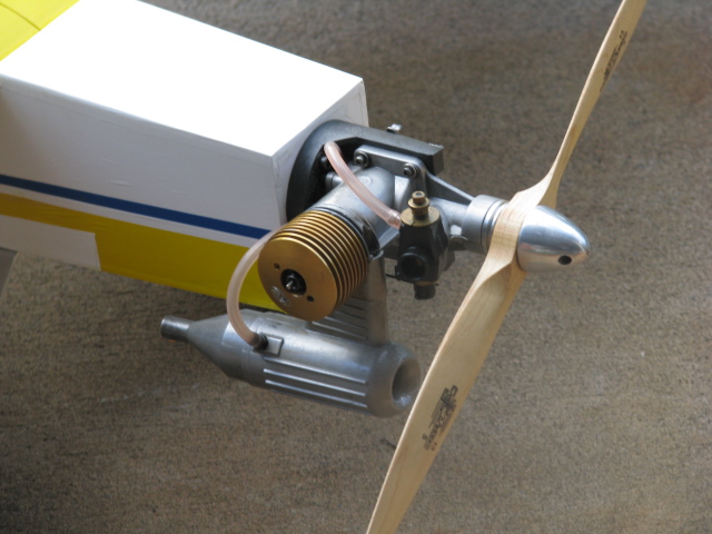

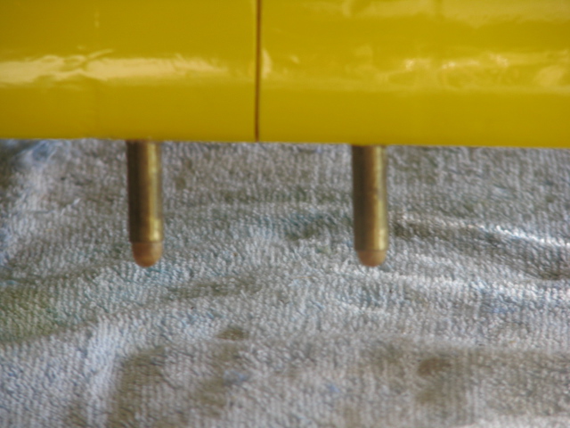

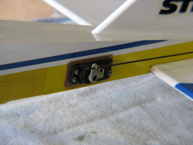

I've an Ultra Stick .40 that I'm now rebuilding after five years and over 400 flights. I needed to install a new fire wall (broke in three different engines on the model...K&B .45 Sportster, K&B .61 Twister and Super Tiger G.90), re-inforce the second bulkhead where the wing pins plug into the fuse, and a re-cover of the fuse. The model is well built, flys very well and I can fly it in high winds. I'm hard on my models, and I abused this model, rode it hard and managed to ware out two sets of tires on the kit. I did install a Kleet Tail Wheel when I first assembled the model, and its still in flyable condition...: )
I placed my servo's aft near the tail, re-inforced the wing pins (installed brass tubes over the wood dowl pins), reinforced the main landing gear floor (inside the model) and flew it first with a four servo wing...and went to a two servo wing later, using flaperons (the programing got to involved for me with my Tx).
I also have had a few less then good landings with this model and the repairs are easy. By the way, I placed my elevator and rudder servo's in the tail for easy access for adjustments and to add a bit of weight in the tail section. Even though the K&B .61 Twister is a light weight engine...placing the servo's aft helped the CG.
