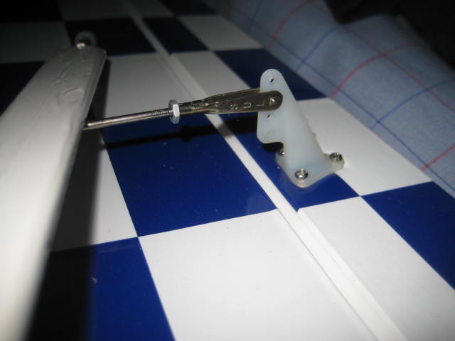

Got this plane from my lovely wife for Christmas and took great care building it. I have been flying a Twist with a saito .82 for about a year and wanted a pattern plain. The build went great with few problems. The first flight went off flawless but I was flying quite slow getting things trimmed out and practicing approaches so I could get it on the ground in one piece. My second flight I made a fairly fast pass out of a dive at idle throttle and could hear a loud buzzing and then i could see the right aileron partially separate from the wing . It went into a right bank and on low rates I did not have the rudder to correct and it crashed. I found both aileron servos stripped the left aileron horn snapped off and the right aileron ripped the ca hinges out of the wing and was hanging on by the push rod. Since it crashed nose first the wings were in perfect condition so I knew it was flutter that caused these problems. After contacting great planes they referred me to a flyer that should of been included with the kit on setting up the servos. After pleading my case to Tower hobbies and sending back the plane, I am pleased to say the replace the plane at no cost (I just had to send what was left of the old one back). I have never experienced aileron flutter this badly and hope the second build goes better. I hope anyone who does this build in the future does get this flyer and does not set up the controls as shown in the manual or they might very will end in a crash as mine did. Thanks Tower Hobbies for their support and giving me a second chance on this one..............
Old 01-27-2010 | 12:47 PM

im glad they were able to help you out, Mlkissel! I would definately put 4-40 control rods on the next one. maybe even some ball joint linkages on the control surfaces.
i must say that this extra is a beautiful airplane! have fun.

The manual does not show the aileron setup all the way in.
Robin,
Why were you using Z-bends instead of the stock hardware... [sm=idea.gif]

i was not impressed with the nylon wirekeepers. maybe thats the whole problem!

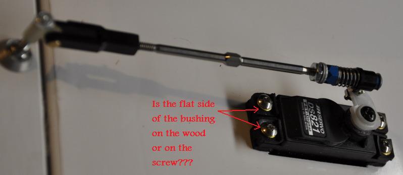

I was looking at your pic and i was wondering if you have your servo grommet bushings installed upside down? just thought id ask since i would hate to see anyone make a mistake and pay for it like I did.
Old 01-27-2010 | 10:54 PM

...forgot to upload the picture that i was asking you about here it is
Old 01-28-2010 | 08:02 AM
  #42
Joined: Sep 2009
Posts: 1,300
From: Bedford, NH
Default RE: GP performance series Extra 300sp Flutter
Good catch, thanks!

I felt pretty silly when someone pointed out to me the metal grommets were upside down; I used to put them in that way too!

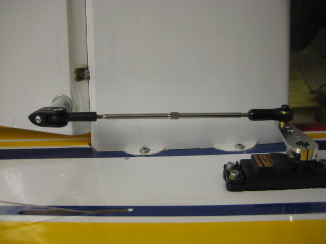

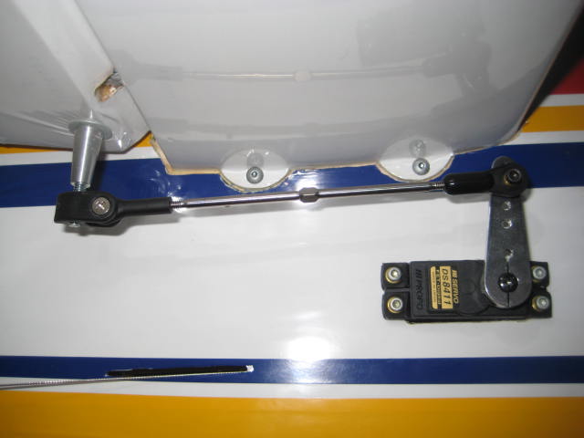

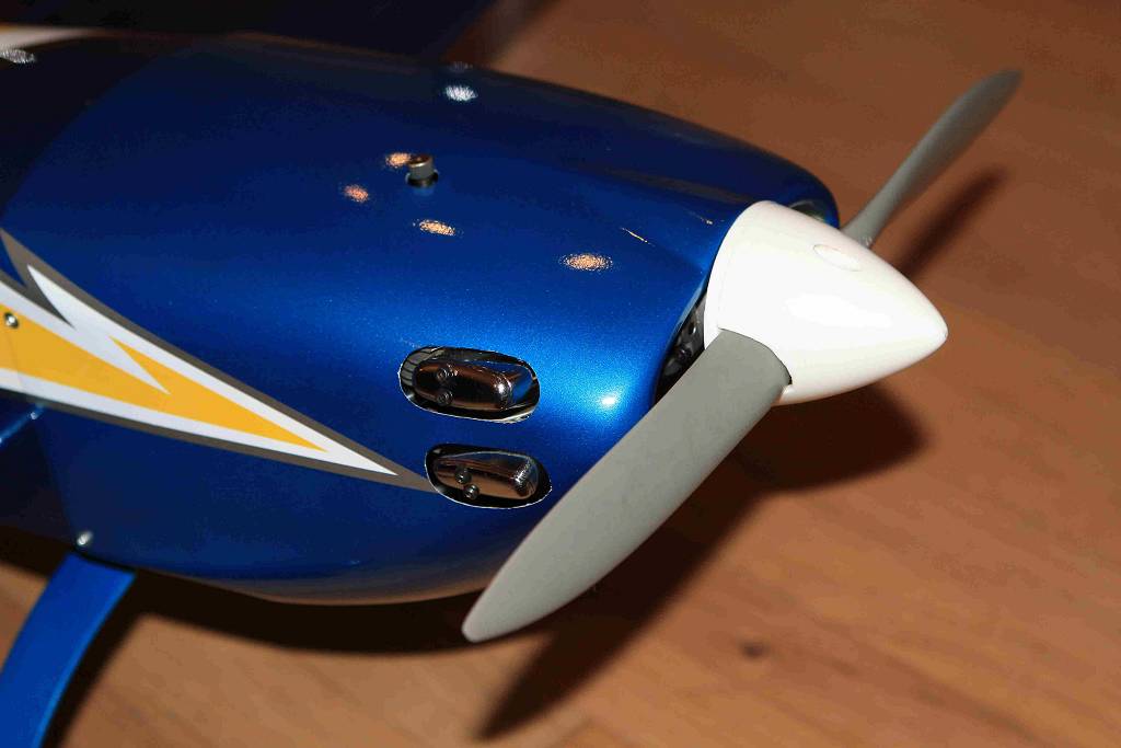

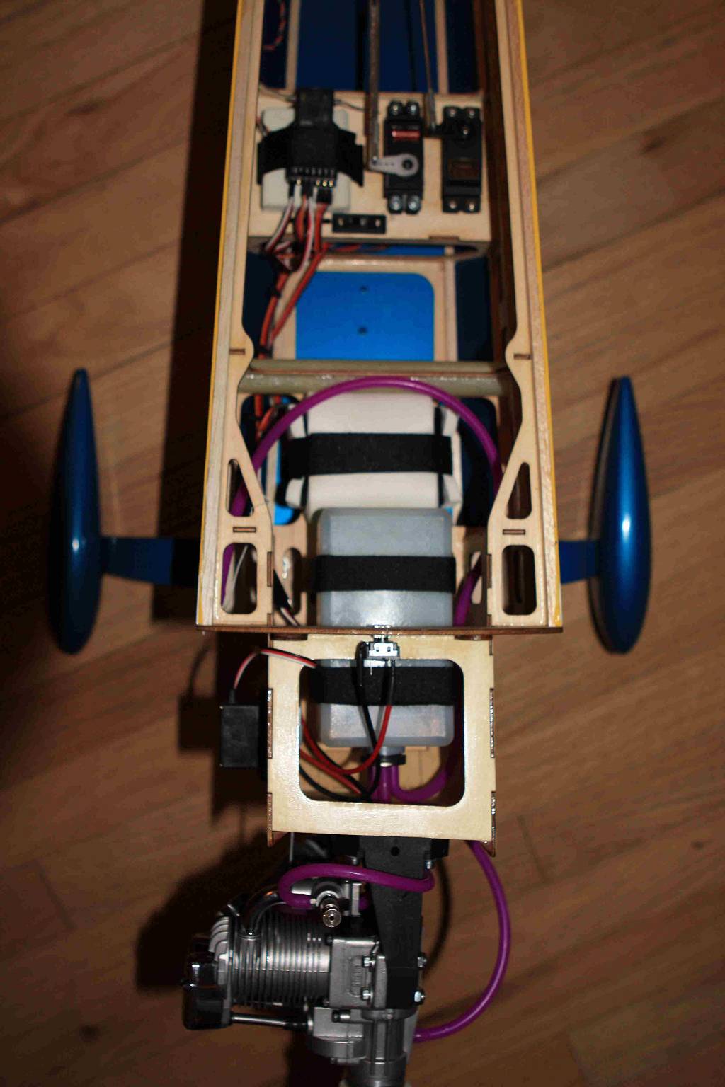

Well, my second build in a month is now finish....first one lost to severe aileron flutter. Now if it would just stop snowing on my runway! Has anyone ever tried to put skies on one of these things. I will try to upload some photos of my build and pass along advice (for what its worth). Wing build, I upgraded pushrods to 4-40 and used MG servos this time. Mounted pushrods on the outer horn of aileron and one hold down on servo; also made a mass balance weight for both ailerons. The directions call for 6 drops of ca per side of hinge. I used about 8 or 9 per side to try to stiffen up the aileron. I read that a stiffer control surface is better. I have heard that some folks have had problems with their hatch coming off in flight. I think the design beautiful but in both of my models the magnets seemed to go too far in the holes. I put a small piece of paper towel in the hole first than the magnet to make it protrude just a bit from the hatch and fuselage. The magnets seem to snap together and hold great. Also a small piece of sticky foam on the top forward part of the hatch to stop the clowl from vibrating and hold the hatch better.
For the engine I used a saito 82a for mine. The only trick I used was to mount the throttle servo facing in towards the fuel tank. This way it was a straight line through the firewall to the engine. The first model I put it on the outside like the directions and made a bunch of bends. Just did not work very well.
Mine balanced about a quarter inch further back than published; about 4" from the L.E. The first one balanced about the same and seamed to fly quite well before it came apart. Anyway, hope this helps those in the future

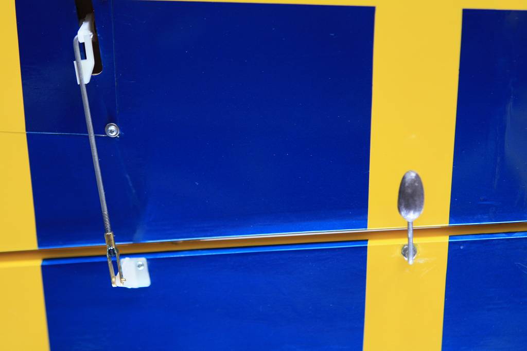

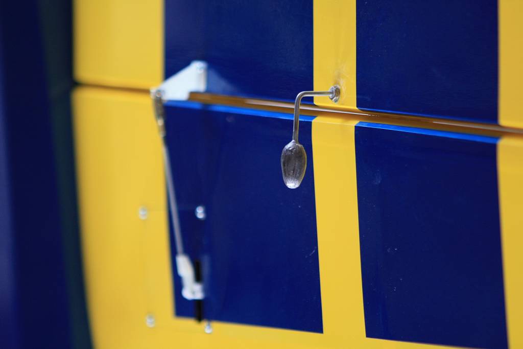

I was able to get a quick reply from GP by going to their web site GREATPLANES.COM and select the contact us link and than fill out an aircraft comment form. Their response was not great, basically said that you must have screwed up the build and that caused it to crash. They did however reference the setup guide that should of been included in the directions. I than contacted tower hobbys support line and told them of the problem and that GP is somewhat responsible due to not having including this critical guide in the directions. They grumbled a bit and than said to send my plane back to them. I stuffed most of the big bits into a box (it was not pretty) and sent it off. Got an e-mail about a week later that said they did not agree with me and that flutter probably was not the cause but they were going to replace the plane nonetheless. Personally, I did not care what they said so long as they sent me a new one. Don't give up and aside from the 20 or so bucks it cost to ship the pieces back you will get a new one. Hope this helps.....
The aileron mass balance weights I saw on this site http://www.rcuniverse.com/forum/m_91...tm.htm#9193633
I figured, what the heck.....
Too much snow for a test flight, I'll post when it gets airborne. Hope this helps.......
