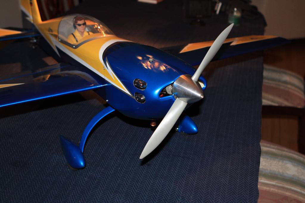

I saw the photos and as soon as I saw where you located the control horn clevis it screamed flutter to me. I've been building and flying r/c since 1974, control line before that. Why did you have the linkage so far in on the control surface?
Also,
I owned the earlier GP300s 40 size and had a Saito 91 in it. It was a great flying plane. The performance series is a lighter version with larger control surfaces.
I remember people complaining about the Funtana 90 fluttering when it first came out. Looking at the photos if the FUntana it was clear the plane had not been assembled properly and the wrong servos were used in the wings.

MLKISSEL - I was was just wondering if you opened you cowling up and to let air flow pass through? I am going to run and AX 55 but didn't want it to over heat if I didn't get enough air flow.....

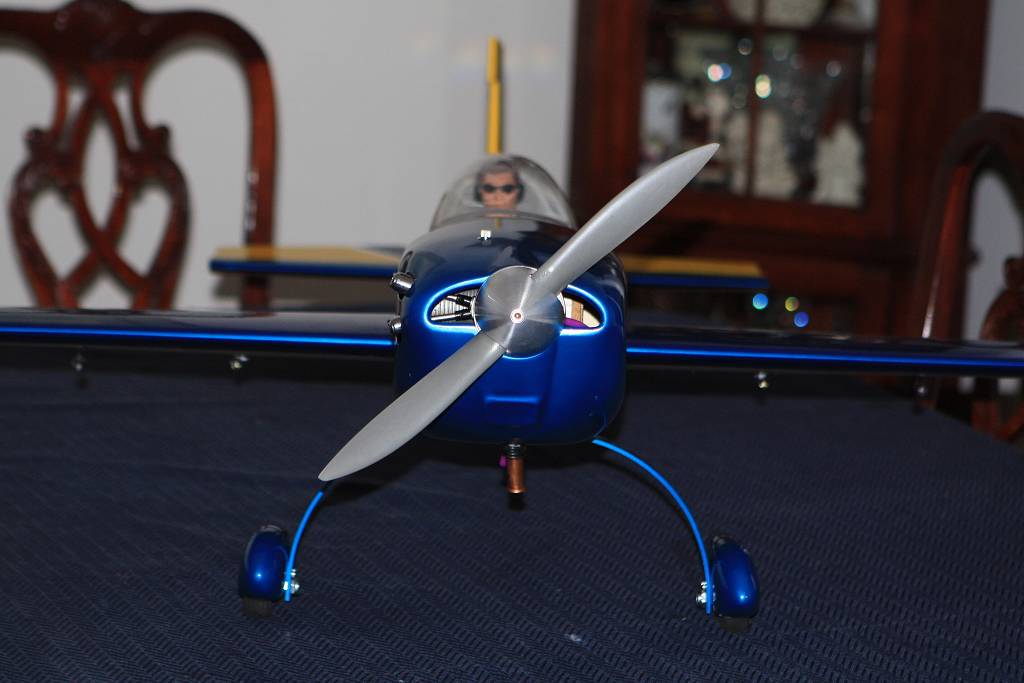

Yes I did add some vents on the bottom of the cow. The can be seen on the previous page of photos, be careful though, I tuned the engine with the cow off, and with the cow on, it get a bit warmer before i realized it. when I accelerated it to full throttle to check again, it misfired and spun the prop off. Better keep it rich until its up to temp.

yo kissel i think you may want to put the plastic spinner in storage for another plane and get a annodized blue or yellow spinner from truturn. i never use plastic spinners/backplates on 4 strokes... plus i tighten the first nut with a wrench so it isnt coming off then snug up the locknut tight. I think blue would be cool on this airplane but i was thinking yellow would be sweet if it matched. JMHO

You are so right, my tru-turn spinner showed up today! Unfortunately I went with S.S. I think its kind of classic for aerobatic airplanes.....than again, I'm getting old. The plastic ones do not hold up. While I was tuning things up I was too lean on throttle up and I spun the prop off and shattered the spinner. I had another on to stick on for tuning. Now that the tru-turn is here, it will go back in the box. Thanks for the advice though.....
