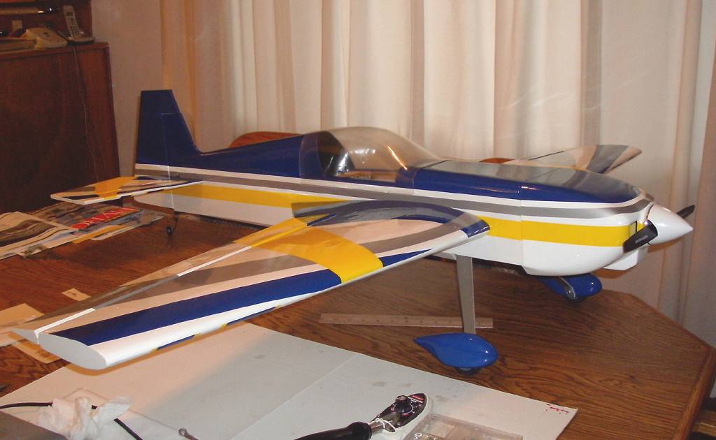

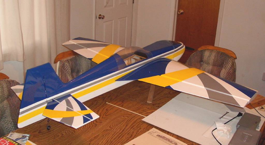

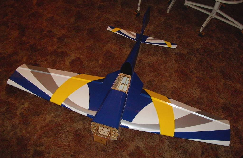

Just got one of these from Abell RC. Haven't seen anything about this plane on the forums, so here goes a build thread.
The box arrived in good shape. Upon opening, everything was well wrapped with protective foam. Unfortunately, the tape straps had come loose, allowing parts to slip around inside. Some dings resulted.
After unwrapping everything, the big disappointment is that the covering is loose on everything. I spent a couple of days ironing it all back together. The covering material seems to be good quality and for the most part, after some work everything looks OK. Unfortunately, part of the rudder didn't go together well, and I'm left with a divot on a trim scheme separation line. Bummer.
The hardware looks reasonable, and the airframe design is nice: very light, with carbon fiber center tube and two-piece wing. The fiberglass cowl in the kit is the nicest one I've ever seen, with a plywood former at the back that ensures perfect alignment with the fuselage. I plan on using a Tower .46 on this one.
A test fit of the parts went well, but the elevator/stab is not in plane with the wing. More grinding is needed. Stay tuned.

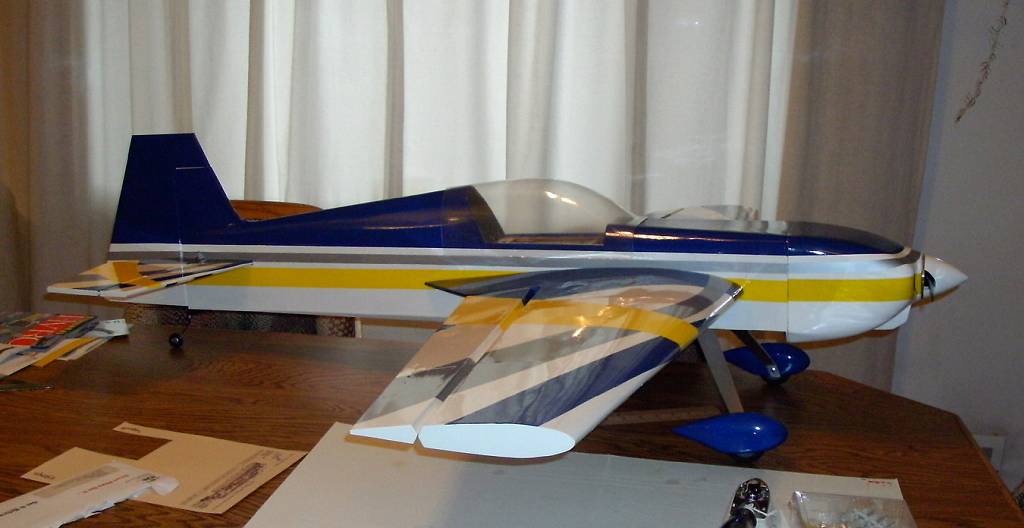

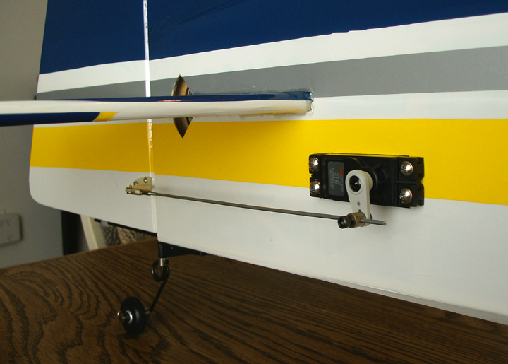

I drilled the holes for the landing gear and got the mains and tailwheel mounted on the fuselage. I'd rather have the fuse sit on the wheels than on the formers and covering. The cowl screws in through the firewall, with the mounting screws hidden by the canopy and the belly cover. When everything's assembled, it's very clean and tidy with no exposed screws. I'm waiting for servos and such, so I put the plane together to check alignment of everything, and it's all good.
On this kit you have the option of mounting the servos on trays inside the fuselage and running pushrods to the tailcone, or mounting the servos on the outside of the tailcone. To keep pushrods short and direct I'm going to put them in the tail. The fuselage is extremely light; mostly of ply and hardwood. All together, this airframe weighs maybe 3.5-4 pounds. Need to get it on a scale for an exact number. It should perform well with a .46; can't imagine stuffing a .61 or .76 in it because of the very light construction.

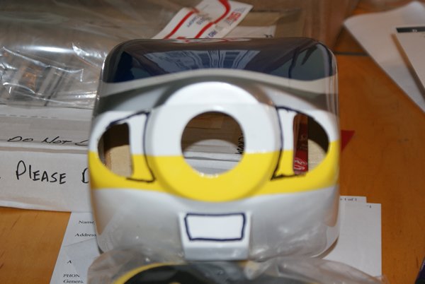

Capt Crash could you post a pic of the front of your canopy section that lifts off, I am
interested in seeing if yours is slotted to clear the cowl attachemnt screws, as that looks

On the canopy of my plane there are two holes in the front bulkhead that line up perfectly with the allen heads of the cowl screws, so it snaps right into place. Also, the CF tube fit perfectly, and so did the wing panels. I put it all together for the photo shoot and everything assembled easily. I did have to grind out the slot for the elevator to get clearance.

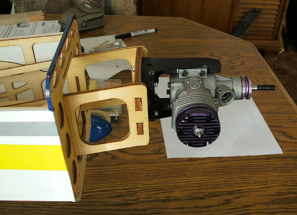

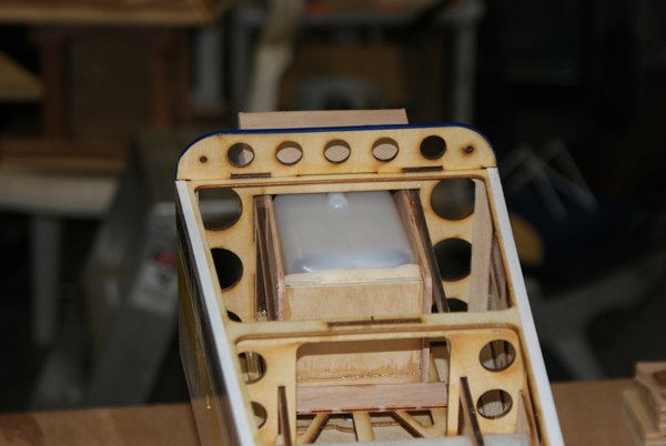

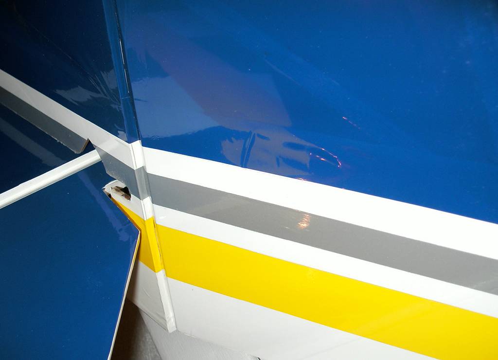

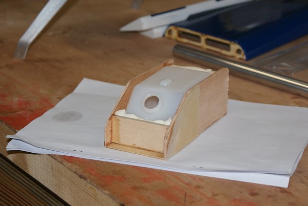

Here are a few pics of the tank tray I made and the boxing of the engine pedestal.
I used 1/16th" aircraft ply for the bottom of the tray and 1/8th" Okahume Plywood,
a marine plywood as strong as aircraft ply but less than half the weight, for the sides
and to box in the engine pedestal. Will mount the servos in aft fuselage for short
direct runs to the rudder & elevator. I have also decided to use my spare Magum 52
XLS with the Magnum Pitts muffler.
The second pic is the slight mod I had to do to the bottom landing gear cover panel.
Bill D.

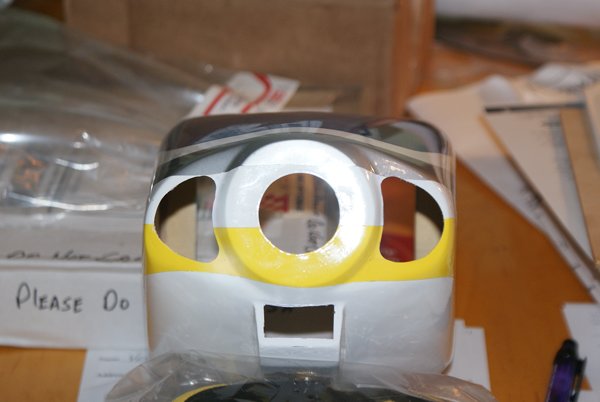

Didn't have a productive weekend on the Velox, but back
on her Monday & Tuesday. Have all of the hinges installed,
tail wheel mounted and this evening re-worked the cowl for
larger air inlets and also made the exhaust outlet for the
Magnum Pitts muffler exhaust extensions. Looks like the
Magnum 52 will fit without a large hole to cut for the head
to stick out, only need a smaller hole for the glow connector.

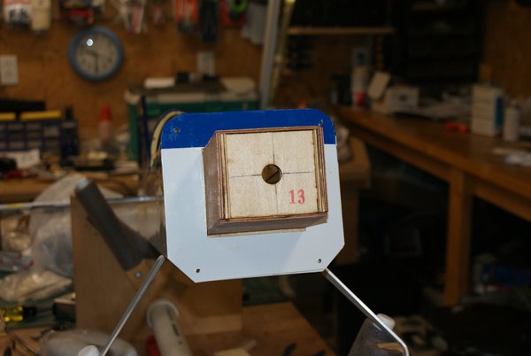

Got the firewall seal up used 1/32nd ply covered with monkote and expoxied
in place to seaL up all holes. Mounted engine last evening and found that
the alignment marks on engine pedestal are off a tad bit and the engine
drive plate is sitting low in the opening in the cowl, will correct with a wedge
and post more pics when done.

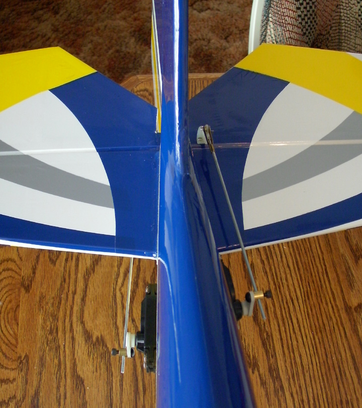

Finished installing all servos. There was no guidance as to how to install and set up the servos in the tailcone, but it went together easily. Will work on finishing the canopy and doing the engine installation today.
